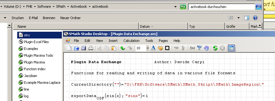

I don't know, how Davide managed to do this, but the DataExchange plugin somehow manages to handle relative paths with respect to the current document (despite the help text mentioning the current dir as default path).
In the attached screen shot you see a document, where a formula is exported using a relative path. The file is created in the directory of the currently open SMath document, even if that is not the current system directory (as can be seen in the CurrentDirectory() output).
May be the approach is not available for custom regions. Then a separate function like "DocumentDirectory()" would help, just as the function "SettingsDirectory()" from CustomFunctions, which is used to build the hyperlink targets in the activebook plugin index.

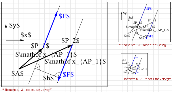

Ok, I'll think about it too. As for svg images, you can change the size of this type of images, but only if the dimensions are not specified in the file. Try these svg-files.
svg.zip (5,06 КиБ) скачан 504 раз(а).
Radovan Omorjan 13.10.2013 03:02:00
#27 Опубликовано: 13.10.2013 03:14:46
I tried your svg pictures uni. You are right, they can be resized but keeping their aspect ratio.
I suppose there is not a way to respect their aspect ratio by dragging the resizing either of the dragging markers (just asking). Actually, we can make it fit - if we want - by dragging the individual markers separately.
#28 Опубликовано: 13.10.2013 05:51:21
Thanks, this works. In my example, I just had to removing this: width="65.29mm" height="52.71mm"

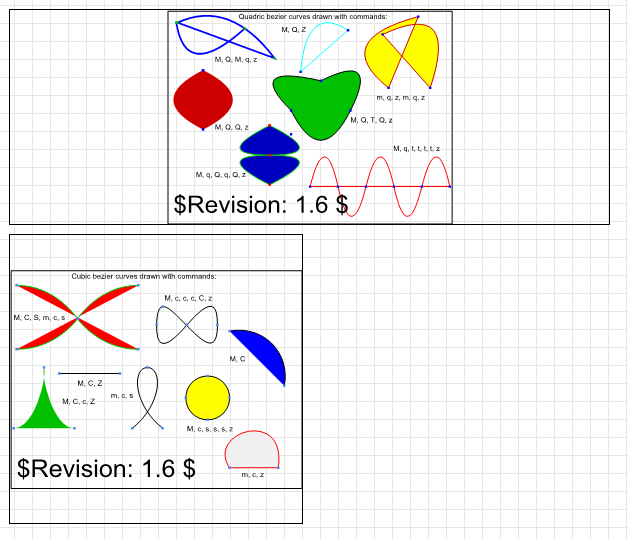

Updated. Added support for svg.
Great feature, thank you Viacheslav

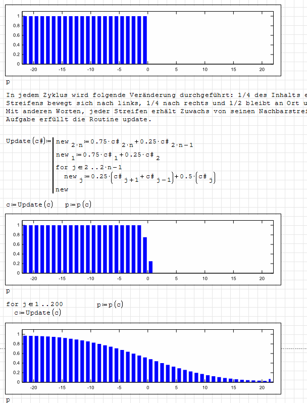

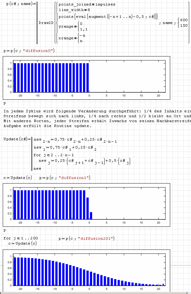

Hmm...I might missed something, but I can not see the plots in the SMath "Diffusion.sm" file. I expected to see them (as usual) but the regions are empty and the *.svg files are not in the active directory (dir variable). See the picture and the log file please.
EDIT: Strange , I managed somehow to get those bargraphs - right bars were decreseing ( by moveing dir:= ). On the third one I saw th problem at the end - but can not reproduce anymore. Still empty regions???
EDIT2: It seems that Maxima restart and few recalculations will bring the plots (second picture)

1. this all applies to SMath 0.96.4909, as the image region is (was) not yet available for the new build (updated Maxima is available on SVN, but still in testing)
2. There might be a timing/robustness issue, it is a bit risky to use identical file names for different plots in the sheet. I changed the sheet such that you get different file names. The images should be produced upon opening or recalculating the sheet.
