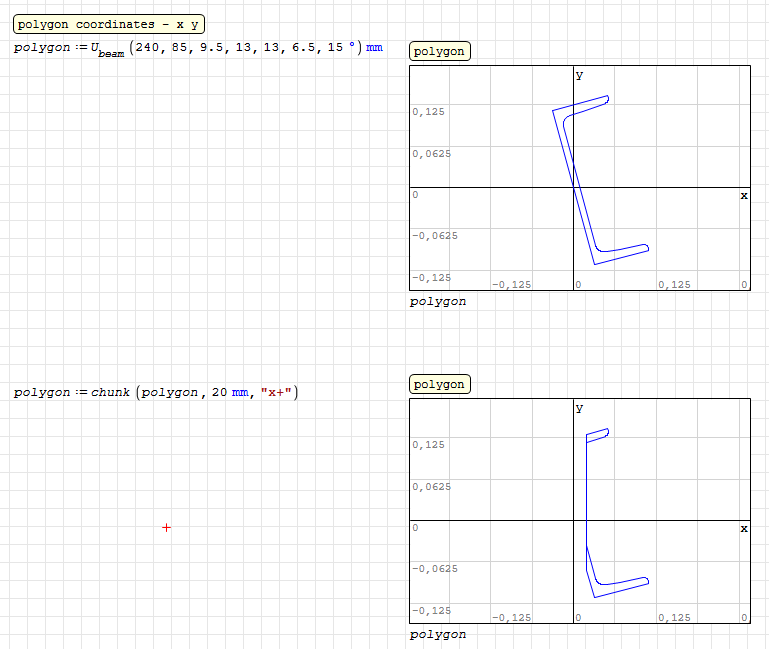

You can try to use chunk() from PolyProperties. For a generic oriented line, you have to rotate the polygon using the line orientation, apply the chunk() function about an axis, and rotate back the polygon.
