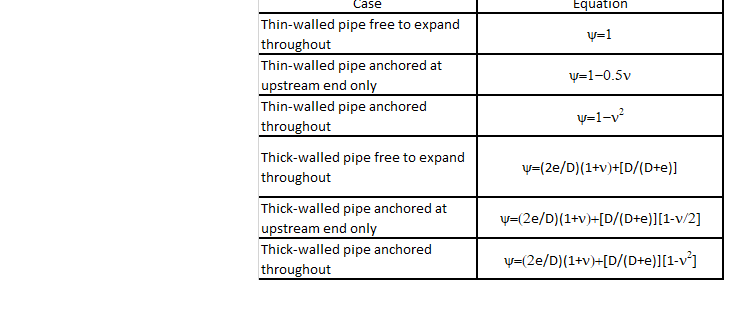

Can text be included in an if statement? For example:
If "Thin-walled pipe anchored throughout" then P=1-v.
I have various conditions that different formulas would be used depending on the conditions, see below.restraints.png

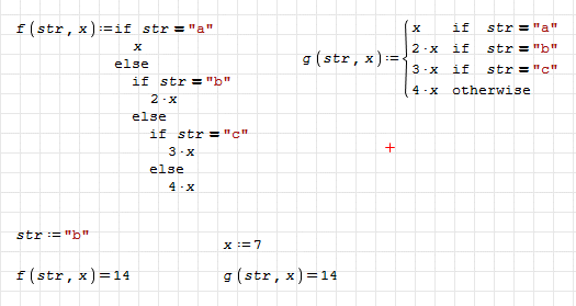

Hi. You have some options for do that. Here are two:
#3 Опубликовано: 01.05.2019 22:04:46
You have some options for doing that.
Easy to complete the conditions, thus the project.
Cheers Alvaro ... Jean

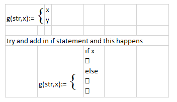

I tried to construct it. My question is how to do that. I try and the below is what happens:if statement.png
#9 Опубликовано: 03.05.2019 13:09:07
g(str,x):=then from menu f(x), then cases, then fill-in

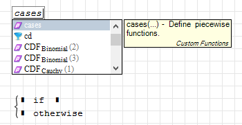

The cases() function is included into the "custom functions" plugin, so you should also be sure to have it installed.
Thank you. I had the "custom functions" plugin installed, but the use of it is not in any of the manuals, at least not that I could find. I had no idea I had to type the word "cases" to get to the input.
