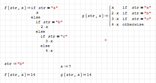

Hi. You have some options for do that. Here are two:
#3 Posted: 5/1/2019 10:04:46 PM
You have some options for doing that.
Easy to complete the conditions, thus the project.
Cheers Alvaro ... Jean

There is no space key to press. Construct the snippet, done.

Construct the math regions as per the image that we call snippet.

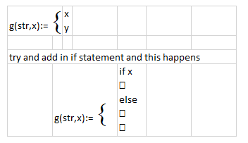

I tried to construct it. My question is how to do that. I try and the below is what happens:if statement.png

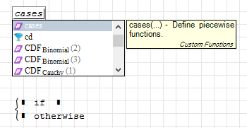

g(str,x):=then from menu f(x), then cases, then fill-in
#10 Posted: 5/3/2019 2:11:45 PM
fedeghi
fedeghi
25 likes in 112 posts.
The cases() function is included into the "custom functions" plugin, so you should also be sure to have it installed.
frapuano 5/3/2019 2:38:00 PM

Thank you. I had the "custom functions" plugin installed, but the use of it is not in any of the manuals, at least not that I could find. I had no idea I had to type the word "cases" to get to the input.
only click the function 'cases' from the f(x) menu.
In the right most place holder of the first 'if'
place the cursor type coma, coma [,,]
that gives another line of conditions ... and so on.
