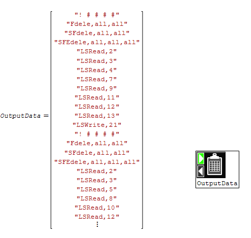

You can try using the plugin "Clipboard Region"
Once installed, go to "insert > Clipboard region" and add one to the canvas, then add the variable in the input placeholder and click on the top arrow to send the data to the clipboard
sergio 17.03.2021 12:28:00

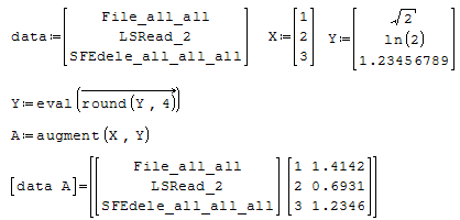

#3 Опубликовано: 17.03.2021 09:56:01

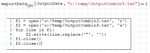

This my temporary solution.
Now i'm want solve problem with paths... May be...
LoadCombination3.sm (15,74 КиБ) скачан 1208 раз(а).
