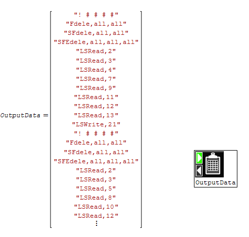

I'm want to export my Matrix with strings to new txt file.
My result - txt file with quotes near all values.
I need file without quotes.
Any Ideas?

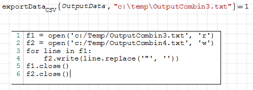

Might just be easier to make a vbscript to drop your output file into that cleans up the data and removes the "". It would be an extra step, but easy to do.

Thank you for ideas.
This my temporary solution.
Now i'm want solve problem with paths... May be...
