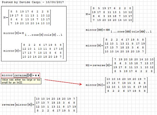

The two red regions created "Unknown error".
The algorithmic chain fails.
Mirror_Problem.sm (20,51 КиБ) скачан 1346 раз(а).
Utilities Matrix Rotate Quadrant.sm (59,03 КиБ) скачан 1350 раз(а).
WroteWhy this happens with attached worksheet?
Mirror_Problem.sm (20,51 КиБ) скачан 1365 раз(а).
You found a bug in el(), thank you!
added in BTS [SS-2438]
WroteYou found a bug in el(), thank you!
Hello Davide,
IMHO, the case reported by collab NDTMA is not a bug.
Simply an instance of "shadow in the context" [Mathematica].
Similar broken algorithmic links have been encountered in Mathcad.
We can't play much with the "vector/matrix" codes.
Here is a similar example in the attached.
Cheers, Jean
