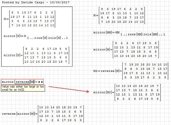

The two red regions created "Unknown error".
The algorithmic chain fails.
Mirror_Problem.sm (20.51 KiB) downloaded 1346 time(s).

WroteWhy this happens with attached worksheet?
Mirror_Problem.sm (20.51 KiB) downloaded 1365 time(s).
You found a bug in el(), thank you!
added in BTS [SS-2438]

WroteYou found a bug in el(), thank you!
Hello Davide,
IMHO, the case reported by collab NDTMA is not a bug.
Simply an instance of "shadow in the context" [Mathematica].
Similar broken algorithmic links have been encountered in Mathcad.
We can't play much with the "vector/matrix" codes.
Here is a similar example in the attached.
Cheers, Jean
