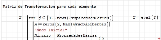

Solve 2D trusses with static loads, temperature changes and node displacements.
Is there a way to improve the speed of the calculations?
sergio 26.08.2021 14:25:00
#2 Опубликовано: 26.08.2021 15:49:32
Hi. Just add T:eval(T) here
sergio 26.08.2021 16:01:00
#3 Опубликовано: 26.08.2021 16:51:04
Is there a way to improve the speed of the calculations ?
From 15 min down to 2 seconds
Damned over killed of labels.
Armadura2Drigidez.sm (129,08 КиБ) скачан 1571 раз(а).
