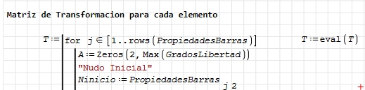

Solve 2D trusses with static loads, temperature changes and node displacements.
Is there a way to improve the speed of the calculations?
sergio 8/26/2021 2:25:00 PM
#2 Posted: 8/26/2021 3:49:32 PM
1,139 likes in 1,805 posts.
Hi. Just add T:eval(T) here
sergio 8/26/2021 4:01:00 PM
#3 Posted: 8/26/2021 4:51:04 PM
Is there a way to improve the speed of the calculations ?
From 15 min down to 2 seconds
Damned over killed of labels.
Armadura2Drigidez.sm (129.08 KiB) downloaded 1571 time(s).
