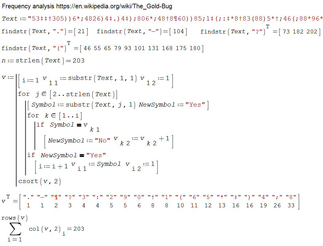

Valery Ochkov
Valery Ochkov
66 сообщений из 690 понравились пользователям.
Gold-Bug.sm (80,3 КиБ) скачан 1199 раз(а).

One issue is that the if statements should be under separate Line arguments, |.
However, correcting that gives a different output to the example so there may be other issues.
Gold-Bug_updated.sm (81,64 КиБ) скачан 1253 раз(а).

Arie
Arie
What is the text string used in the Mathcad File? I can see in the Text string in SMath that no "]" character exists. So I would not expect to have the same result as the Mathcad screenshot.

Valery Ochkov
Valery Ochkov
Thanks to all!
Gold-Bug.sm (12,78 КиБ) скачан 1227 раз(а).
