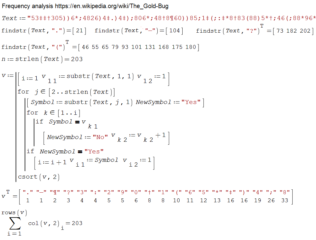

#1 Posted: 10/19/2023 5:44:00 PM

#2 Posted: 10/19/2023 6:56:08 PM
Gerry_Bush
Gerry_Bush
12 likes in 14 posts.
One issue is that the if statements should be under separate Line arguments, |.
However, correcting that gives a different output to the example so there may be other issues.
Gold-Bug_updated.sm (81.64 KiB) downloaded 1292 time(s).

#3 Posted: 10/19/2023 9:11:41 PM
Arie
Arie
94 likes in 285 posts.
What is the text string used in the Mathcad File? I can see in the Text string in SMath that no "]" character exists. So I would not expect to have the same result as the Mathcad screenshot.

#4 Posted: 10/19/2023 9:29:29 PM
Valery Ochkov
Valery Ochkov
66 likes in 690 posts.
Thanks to all!
Gold-Bug.sm (12.78 KiB) downloaded 1265 time(s).
