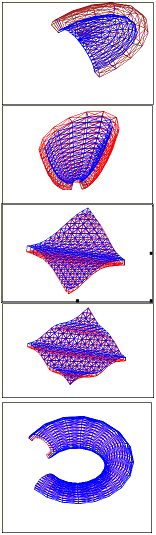

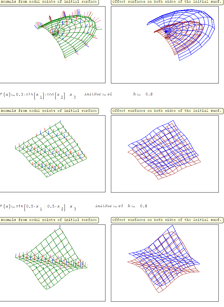

An initial surface is given, given by the "createmesh" function, which forms a
network with nodes.
Dyou want to create an offset surface, offset by an amount h from the initial.
The direction of displacement surface epends on the sign of h.
Sequence of calculation:
1.Restoring the normal from the nodal points of the initial surface and we get
the nodal points of the displaced surface.
2.We connect the resulting node points
The image is built on three-dimensional graphics and can be rotated with the mouse
Andrey Ivashov 19.10.2021 13:48:00, Oscar Campo 20.10.2021 18:42:00, Davide Carpi 20.10.2021 08:27:00, Alvaro 10.10.2021 20:58:00

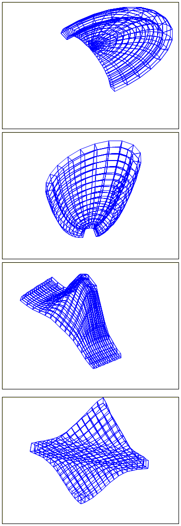

Converting Surfaces to Solids
The solid is formed from the initial surface, the offset surface, and the
lateral surface that connects them. The lateral surface is formed by normals
reconstructed from the boundary nodal points of the initial surface.
Solid.sm (36,96 КиБ) скачан 1544 раз(а).
Solid.pdf (309,58 КиБ) скачан 909 раз(а).
Alvaro 20.10.2021 23:56:00

#8 Опубликовано: 21.10.2021 04:31:50
Hi Fridel. Thanks, great job. In the attached an alternate mesh. Its advantage is that it consists of a single coordinate matrix, so it can be manipulated more easily, with translations, rotations and deformations. As disadvantages, it does not look so good and there may sometimes be a wrong line, but I guess only one.
pSolid_alternate_mesh.sm (51,99 КиБ) скачан 1468 раз(а).
pSolid_alternate_mesh.pdf (391,97 КиБ) скачан 851 раз(а).
Fridel Selitsky 21.10.2021 05:07:00

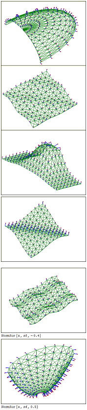

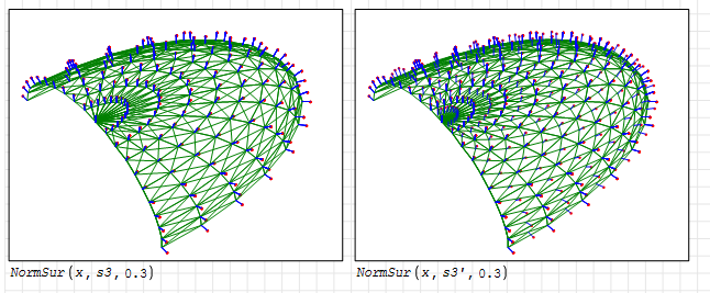

Normal to the surface on Rezonar's triangular mesh
NorSurAlvaro.sm (49,33 КиБ) скачан 1577 раз(а).
NorSurAlvaro.pdf (623,77 КиБ) скачан 906 раз(а).
Alvaro 24.10.2021 23:40:00

#11 Опубликовано: 25.10.2021 22:06:52
Hi. The same but with a different version for the triangular mesh.
NorSurAlvaro v2.sm (77 КиБ) скачан 1482 раз(а).
Davide Carpi 26.10.2021 14:08:00, Fridel Selitsky 25.10.2021 22:55:00

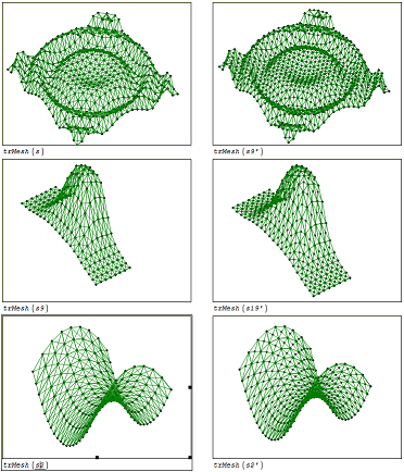

Examples of meshes with vertices
Nodes.sm (49,04 КиБ) скачан 1540 раз(а).
Davide Carpi 26.10.2021 14:08:00, Alvaro 26.10.2021 05:20:00

Creating surface thickness with triangular meshes
thickness.sm (56,02 КиБ) скачан 1579 раз(а).
thickness.pdf (732,98 КиБ) скачан 940 раз(а).
