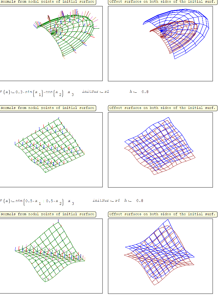

An initial surface is given, given by the "createmesh" function, which forms a
network with nodes.
Dyou want to create an offset surface, offset by an amount h from the initial.
The direction of displacement surface epends on the sign of h.
Sequence of calculation:
1.Restoring the normal from the nodal points of the initial surface and we get
the nodal points of the displaced surface.
2.We connect the resulting node points
The image is built on three-dimensional graphics and can be rotated with the mouse

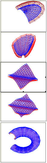

Converting Surfaces to Solids
The solid is formed from the initial surface, the offset surface, and the
lateral surface that connects them. The lateral surface is formed by normals
reconstructed from the boundary nodal points of the initial surface.
Solid.sm (36.96 KiB) downloaded 1544 time(s).
Solid.pdf (309.58 KiB) downloaded 909 time(s).

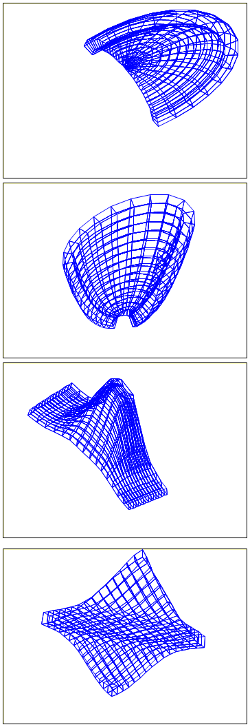

Hi Fridel. Thanks, great job. In the attached an alternate mesh. Its advantage is that it consists of a single coordinate matrix, so it can be manipulated more easily, with translations, rotations and deformations. As disadvantages, it does not look so good and there may sometimes be a wrong line, but I guess only one.
pSolid_alternate_mesh.sm (51.99 KiB) downloaded 1468 time(s).
pSolid_alternate_mesh.pdf (391.97 KiB) downloaded 851 time(s).

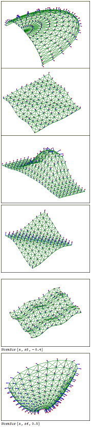

Normal to the surface on Rezonar's triangular mesh
NorSurAlvaro.sm (49.33 KiB) downloaded 1577 time(s).
NorSurAlvaro.pdf (623.77 KiB) downloaded 906 time(s).
Alvaro 10/24/2021 11:40:00 PM

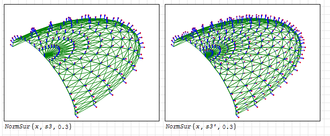

Hi. The same but with a different version for the triangular mesh.
NorSurAlvaro v2.sm (77 KiB) downloaded 1482 time(s).

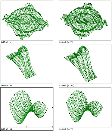

Creating surface thickness with triangular meshes
thickness.sm (56.02 KiB) downloaded 1579 time(s).
thickness.pdf (732.98 KiB) downloaded 940 time(s).
