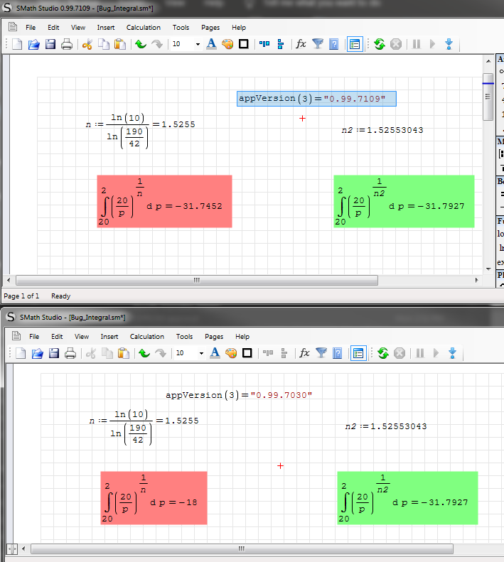

I have a simple integral calculation which contains a varable "n". If this variable is calculated in an earlier step, a wrong result is returned; the same calculation with a defined value for the variable (called "n2" in the example), the correct result appears. SMath Studio version 0.99, build 7030.

What version are you running?
I'm not seeing this issue on 7109.

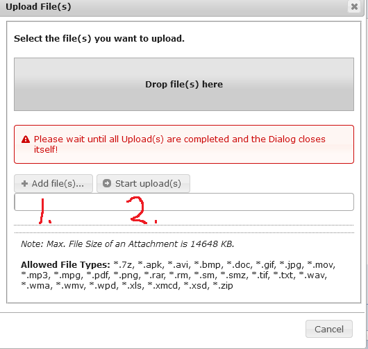

Sorry I missed this. To upload start writing a comment, click the following button....
then click add file first. Navigate to file and select. Then you must click start upload to upload it.
Are you concerned with the fractional result on the red?
If so right click on that section and change optimization to numeric. You'll get a numeric result.
Doesn't help, I still get "-18" in the left section (which isn't correct IMHO and still deiffers from the result on the right side (green))

Doctored SS 6179 ... seemingly same as SS7109
