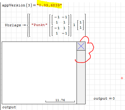

At the moment I cannot drag any object from the template pane to the modeller region.
I am using 0.99 (6839)
But you can test it easily by opening the example in the first post online. There it doesn't work, too.
Also the tooltip by hovering the any template objects appears only rarely.
Editing already exiting objects works fine.

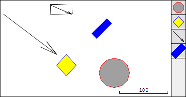

The "Drag and drop" function is not working.
I have downloaded an examples with modeller region and I can move/change shapes in modeller but I can't add new shapes from templates bar.
Does anybody can help ?
#46 Опубликовано: 18.11.2018 21:11:55
You can only add shapes that you have created or borrowed from unknown sources
In this document, two objects were created and installed in the template
N =5 => yellow square
N 13 => light gray dodecagon
Check if it works in your SS version
modeller-demo-Kr.sm (15,04 КиБ) скачан 1538 раз(а).

#48 Опубликовано: 19.11.2018 06:00:38
Updated, please try now.
#49 Опубликовано: 19.11.2018 13:18:05
Dominik Skrycki
Dominik Skrycki
Thank you Davide for help.
Now I can drag and drop shapes but I can't zoom in and out shapes using mouse scroll.
#50 Опубликовано: 19.11.2018 20:37:39
You're welcome
You can only zoom the modeller canvas, not the single shapes (even in previous versions).
P.S. another update made because templates weren't detected on mouse move (no template name shown, f.e.)

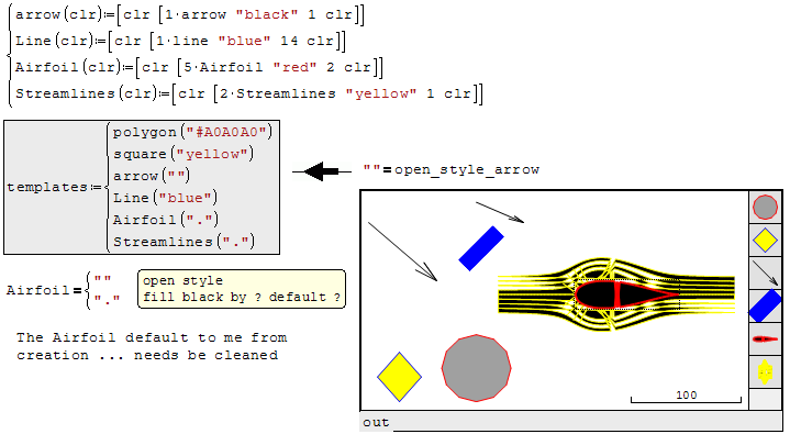

#51 Опубликовано: 19.11.2018 21:21:08

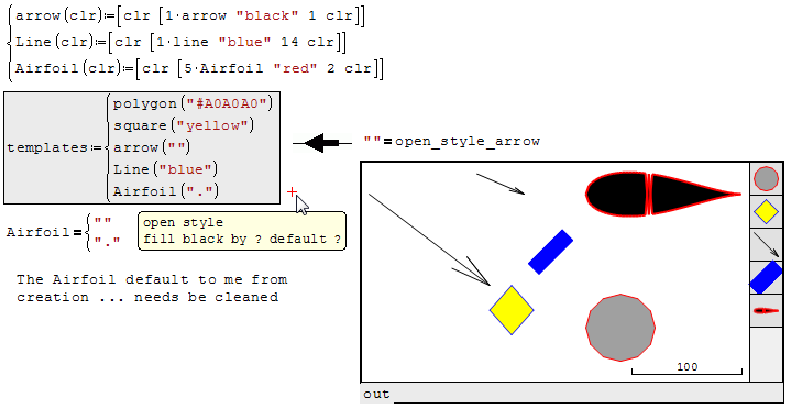

SS 6179, zoom is by handles and thus fabricate otherwise than native.
1. The blue line come automatically 45° ... make it as thick as desired.
2. The arrow, you can rotate at will from the creation.
Observe the the empty "" fill arrow
3. Fill color applies to closed shapes
4. for some weird figure it can be done by digitizing and collecting the XY vector.
Modeler takes only pairwise XY vector ... not matrix
modeller-demo-Kr.sm (27,66 КиБ) скачан 1516 раз(а).
#52 Опубликовано: 19.11.2018 22:05:03

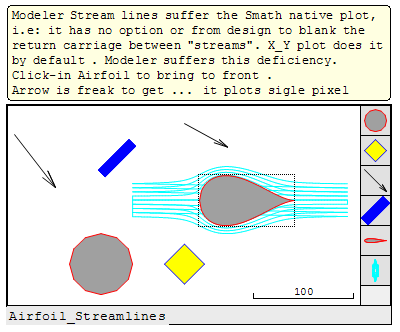

... Airfoil added Observe => [5*Airfoil,"red",2,clr]
modeller-demo-Kr.sm (39,55 КиБ) скачан 1537 раз(а).

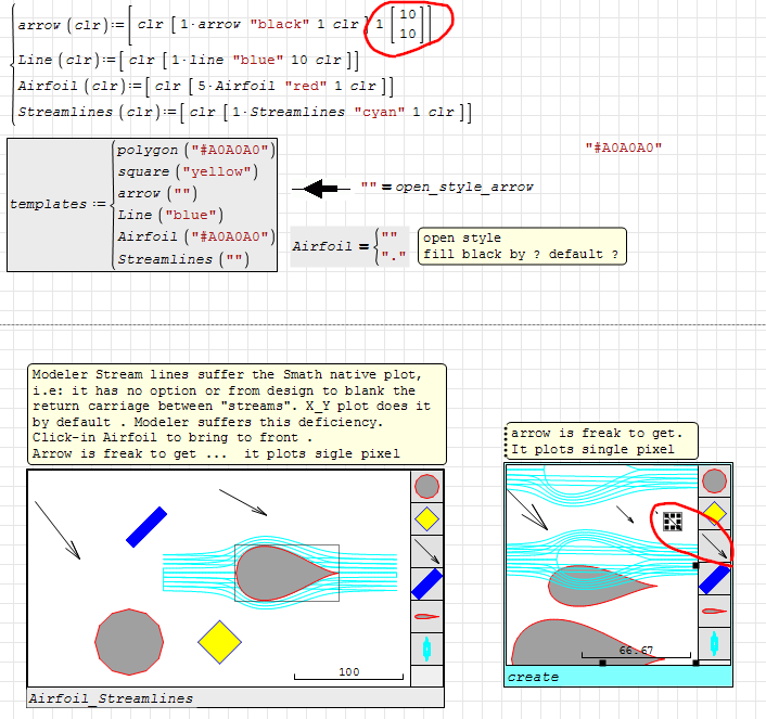

#53 Опубликовано: 19.11.2018 22:32:35
... streamlines added around airfoil
Some cleanup needed ...
modeller-demo-Kr.sm (133,16 КиБ) скачан 1566 раз(а).

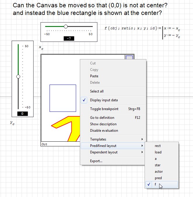

Is there anyway to have the center of the modeler canvas moved so that (0,0) is not at the center?
See attached.
Modeller - Shapes - Canvas Center.sm (11,29 КиБ) скачан 1543 раз(а).

Jean, in your example you could specify an appropriate default size of the objects. Then the arrow template doesn't appear as a single dot any more.
#59 Опубликовано: 03.01.2020 10:47:42
Yes, but to make it interactive, you need slider regions. Use a function as predefined layout. It's third and fourth arguments are channels to convey the canvas co-ordinates.
The canvas is centered at these co-ordinates, evaluated for the default scale.
The default scale is given by the second entry of the dependent layout row vector.
Modeller%20-%20Shapes%20-%20Canvas%20Center_Kr.sm (13,6 КиБ) скачан 1821 раз(а).
