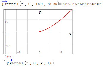

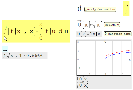

You can slide any decoration over a variable name
... or over a function definition ... even an arrow !

You can have some circomflex hat as well from Charmap.
All or most Charmap can bear function name, even single arrow.
Take care Basile ... old Collab ... Jean.

#12 Опубликовано: 08.05.2023 08:33:43
You can have 'arrow(s)' as variable name
Take care Basile ... Jean.
BasileArrow.sm (28,75 КиБ) скачан 1380 раз(а).
