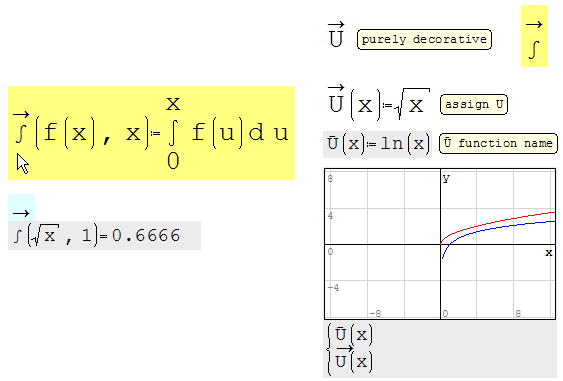

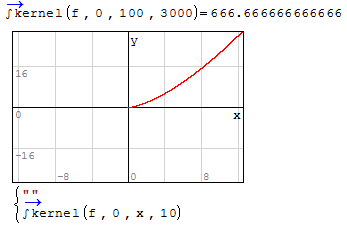

You can slide any decoration over a variable name
... or over a function definition ... even an arrow !

You can have some circomflex hat as well from Charmap.
All or most Charmap can bear function name, even single arrow.
Take care Basile ... old Collab ... Jean.

You can have 'arrow(s)' as variable name
Take care Basile ... Jean.
