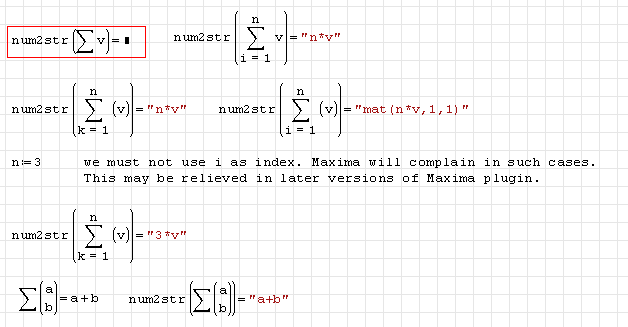

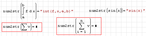

#1 Опубликовано: 24.08.2013 01:42:23
num2str() fails to convert a sum to a string. In the sum(1) example "syntax is incorrect", in the sum(4) example "n is not defined".
Edit: This is now BTS issue SS-43
#2 Опубликовано: 24.08.2013 03:48:22
I confirm and add some further example.
[albumimg]284[/albumimg]
[smath 0.96 (build 4884) W7 64bit]
#3 Опубликовано: 20.09.2013 12:26:06
This is the current state. sum() now can produce symbolic results.
num2str() should provide a string corresponding to the unevaluated expression if it cannot be evaluated.
