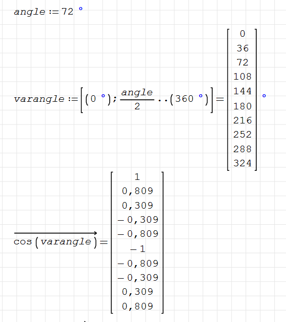

Correct me if i'm wrong, trigonometric functions don't support arrays currently.
For now, you can do something like this.

You can convert the vector into a system (by w3b5urf3r_reloaded)

WroteCorrect me if i'm wrong, trigonometric functions don't support arrays currently.

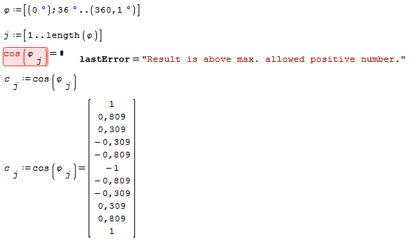

did arrays appear in trigonometric functions?
An alternative to the vectorize() function is the use of index vectors.
They, however, only work if they are used in a definition.
Worksheet1.sm (5,28 КиБ) скачан 1639 раз(а).
