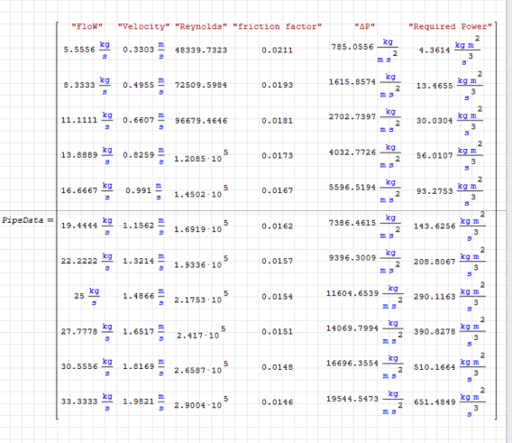

Does anyone know how to change the following units in the matrix shown below?:
from "kg/s" to "t/hr",
from " kg/{'m*'s^2}" to meters Water Column ("mH2O"),
"{'kg*'m^2}/{'s^3}" to Watts.("W")
Colebrook_SI_CBG.sm (29,41 КиБ) скачан 1290 раз(а).

Hola Carlos. You can use matrix algebra in the unit placeholder. Here one solution.
Colebrook_SI_CBG.sm (24,74 КиБ) скачан 1322 раз(а).

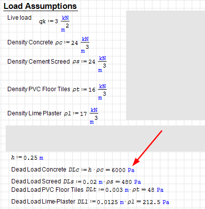

WroteHow do I set my units so my answers are in the unit I want?
Your attached document is fine. Jean's computer is broken.
About your question, there is a placeholder within results.
It will appear when you select result. It appears as a black square.
You can change your desired result units by altering it.
Here is a demonstration how you can do that.
