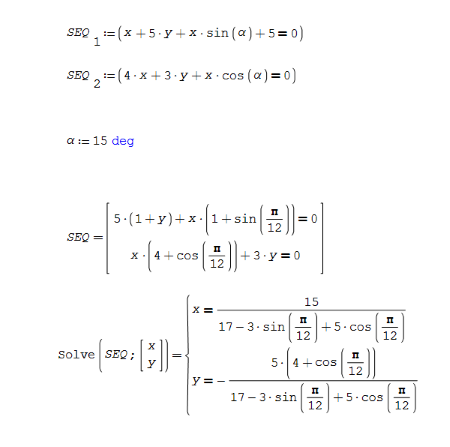

How to turn of the decimal values in trygonometry angles value? I got sth lik this for solution of system of equations:

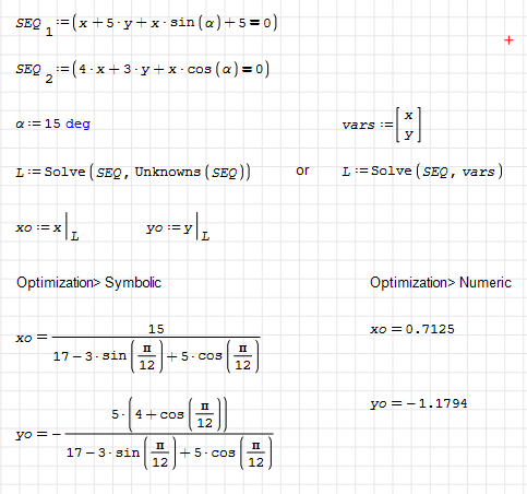

You can use the function al_nlegsolve with any initial
assumptions (because the equations are linear)

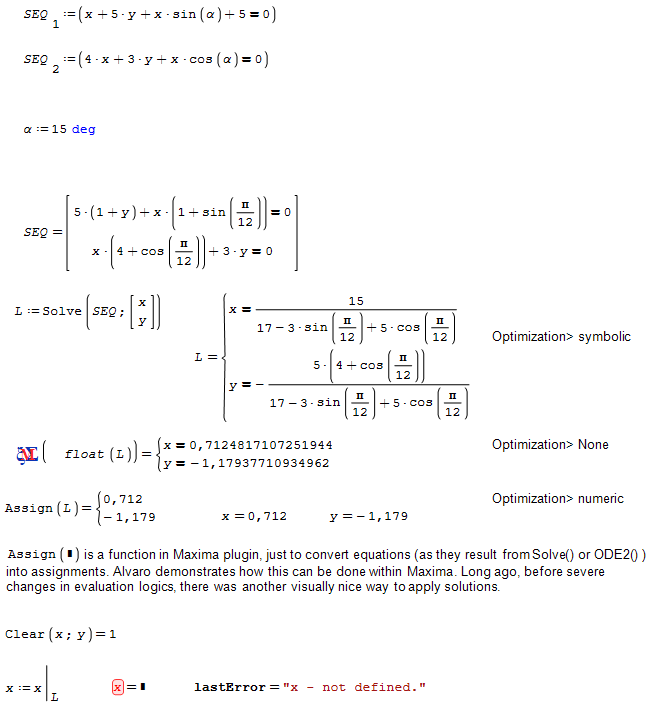

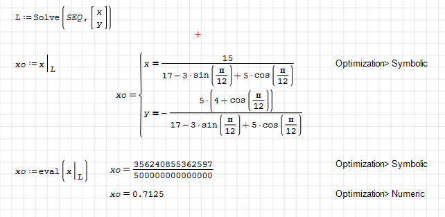

Hi Martin. I use Maxima's ev() because SMath's Assign() only works with the variable names, instead others, like xo, yo, and SMath's at() doesn't works for the symbolic evaluation, as shown this picture:
example_v1.sm (15,95 КиБ) скачан 874 раз(а).

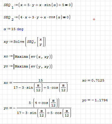

This is a workaround for use only SMath native functions or plugins, without any explicit Maxima function:
example_v2.sm (15,16 КиБ) скачан 940 раз(а).
