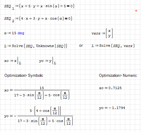

#1 Posted: 9/9/2021 4:25:42 AM
How to turn of the decimal values in trygonometry angles value? I got sth lik this for solution of system of equations:
The file with example: example_v1.sm (8 KiB) downloaded 724 time(s).

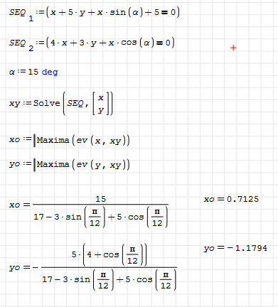

Hi Martin. I use Maxima's ev() because SMath's Assign() only works with the variable names, instead others, like xo, yo, and SMath's at() doesn't works for the symbolic evaluation, as shown this picture:
example_v1.sm (15.95 KiB) downloaded 727 time(s).
This is a workaround for use only SMath native functions or plugins, without any explicit Maxima function:
example_v2.sm (15.16 KiB) downloaded 776 time(s).
