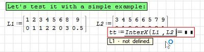

Hello ndtma,
L1 is defined just near tt. You may try to move the tt definition a bit below in the page, to be sure that L1 definition comes first.
Regarding indefinite running, please be advised that due to the more complicate example that comes below in the sheet, the full worksheet takes 6,5 minutes on a pretty good hardware. Other hardwares may require more time, that could seem an indefinite time...
Try deleting the more complicate example, leaving only the simple one.
It should run in less than 1 minute.
Thanks
Marco
Thanks
Marco

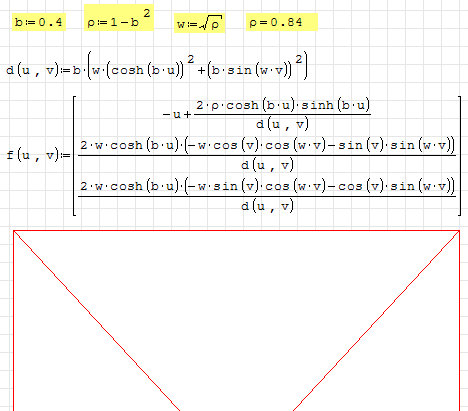

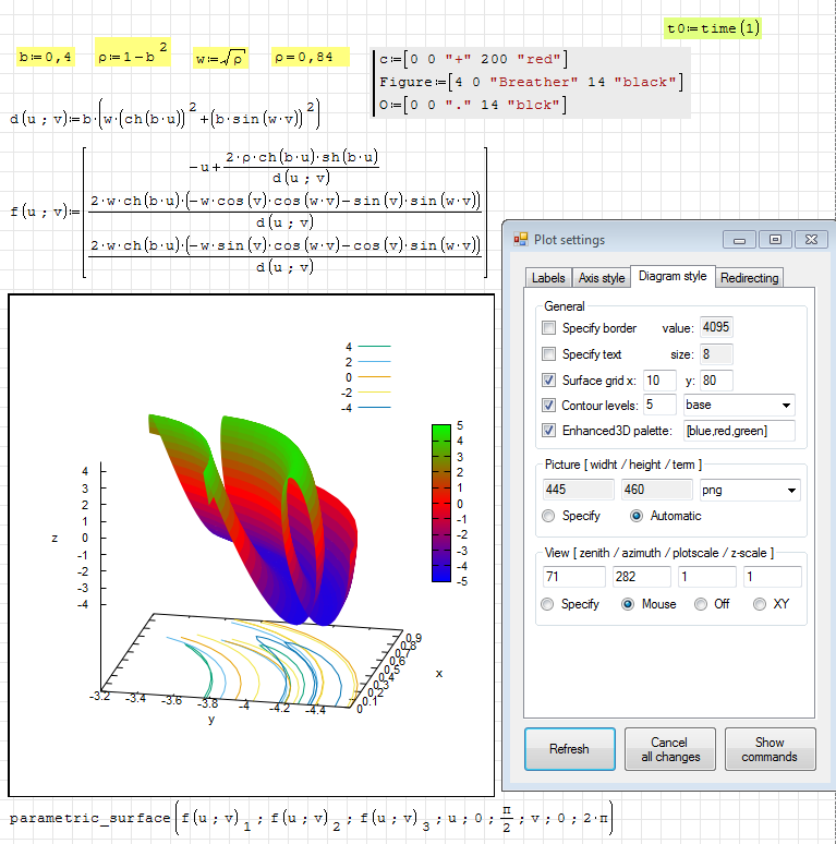

WroteStill on line intersections.
Some notes about "Vector partnership"
You mentioned Scilab [what a piece of software !!!], can't manage, removed from my box.
3D colors from whatever source is not available in Smath. Maxima as suggested by Martin,
complains ... useless. For your interest, Scilab should render the famous "Breather".
Attached as well.
Maths InterseX.r1.sm (65,4 КиБ) скачан 1262 раз(а).
Breather for UNI.sm (308,66 КиБ) скачан 1280 раз(а).
Rotate Breather [4 Orientations].sm (1000,85 КиБ) скачан 1079 раз(а).

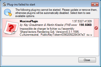

frapuano 18.05.2020 14:27:00
WroteOn starting Smath session, some dependencies aren't accessed.
Starting Smath, always get that error message, close, up running fine.
As it looks, only the Maxima X_Y. 3D surface and those from menu work.
NONE of "draw 2D, 3D, implicit, explicit as you suggest ..." work.
Thanks Martin for being there in Smath Community.

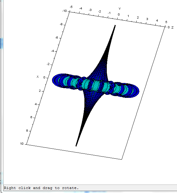

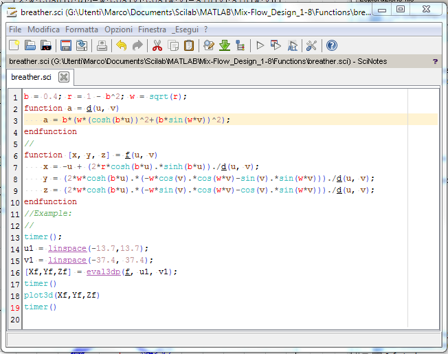

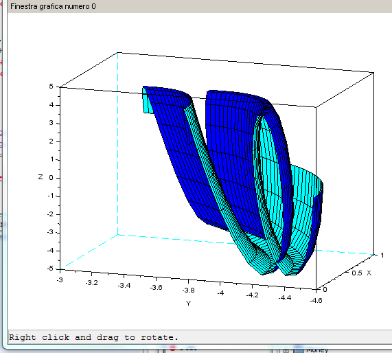

Jean,
I tried to render the Breather in Scilab.
The code is as small as this:
and it runs as fast as this, considering that U and V are given with 100 points each:
and this is the result:
from this side seems ok, but moving it a little bit it appears like this:
I am not sure if this is the expected result, but however I spent only 15 min on it up to now.
I'll check better if I messed something.
Thanks
Marco

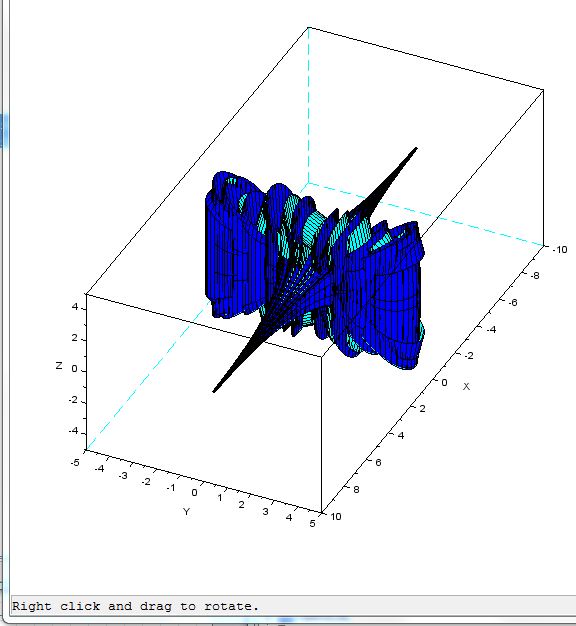

Thanks
Marco
Ok, using limits shown by Martin [(0, pi/2); (0, 2pi)]
I got something more similar to his result:
I'll work to see how to get the level curves.
Being Scilab an open source program, any chance that somebody could develop
a dedicated plugin?:d
Maybe this is more a subject for the "Feature Request" Forum...
Marco
Marco
WroteWroteOn starting Smath session, some dependencies aren't accessed.
Are you using the current stable or development version of SMath?
Older versions won't work with the current plugin, as there were significant changes in the API.
If you follow the link in my signature you find instructions how to install a portable distribution with Maxima. The benefit of having a portable installation is that it won't interfere with an installed version of SMath and can be tested separately. So you don't need to spoil your familiar working environment.
If maxima still won't work, then please report the system information as obtained with Insert> Development tools> System Information.
Thanks for your help.
