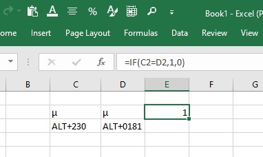

I am used to typing mu directly in other applications (such as MS Excel or gmail) by using the ALT code. I hold the alt key, type "230" on the number pad, then release the alt key. I learned I could also use ALT+0181 to get the same thing.

Hi. You're right, SMath can't recognize the difference. But MS Excel neither, or at least I cannot define in excel one that is different from the one called 'micro' in the windows' character map.
Mu-Micro.xlsx (8,22 КиБ) скачан 1338 раз(а).
