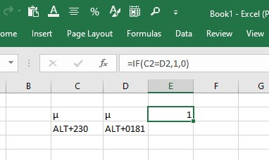

Hi. You're right, SMath can't recognize the difference. But MS Excel neither, or at least I cannot define in excel one that is different from the one called 'micro' in the windows' character map.
Mu-Micro.xlsx (8.22 KiB) downloaded 1338 time(s).

My US keyboard alt230, alt0181 = µ
Bold to highlight
