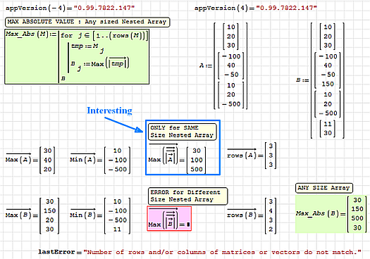

#32 Опубликовано: 22.08.2021 10:28:04
NDTM Amarasekera
NDTM Amarasekera
Vectorize function on Nested Array revisited.
Cheers!
