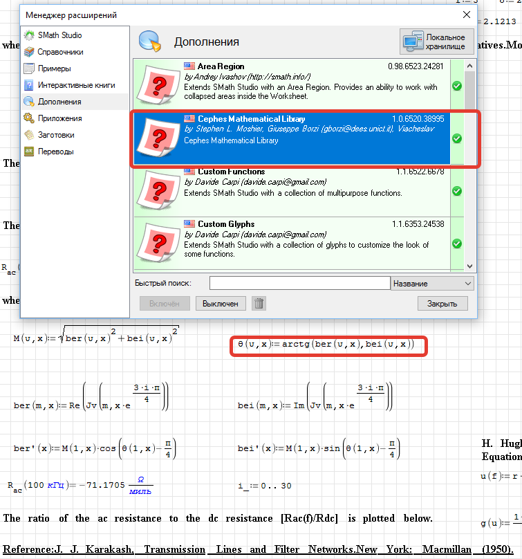

My first post. I'm trying SMath instead of MathCad P4.Файл не найден.Файл не найден.
Having difficulties transferring the RF resistance sheet from MC15. The ber, bei functions are missing. I added plugin EFI for Mathcad for the "Jv" (vs. Jn) function but it doesn't appear in the listing of available functions.
Attached is the mc file and my attempt to transfer to SMath.
I welcome the collabs help to move forward.
Sincerely,
nasch

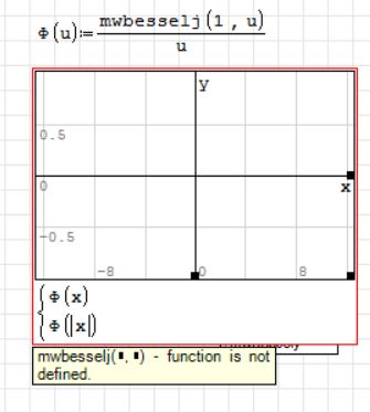

#3 Опубликовано: 29.11.2017 22:23:52
Norm Schutzkus
Norm Schutzkus
9 сообщений из 90 понравились пользователям.
Thanks, for your reply. Unfortunately, I do not see "mwbessl..." listed. Maybe something that I need to activate? Is there a certain plugin I need to load?
Thanks, again
#4 Опубликовано: 30.11.2017 13:23:56
You may have to install from the plugin list.
Click on "Tools", click "Plugins" ... install all.
Otherwise, rescue to "Smath Doctors" ... [Martin, Davide ...]
Bessel Midwest.sm (8,83 КиБ) скачан 1096 раз(а).
#5 Опубликовано: 30.11.2017 14:32:40
Norm Schutzkus
Norm Schutzkus
Thanks, again. Unfortunately, the "mwbessel..." function are not defined. I have 23 plugins loaded, all with green check-marks so I think they are all working. "Install all" is not there.
Then again, I do not have admin rights (my work PC), so that may be a problem?

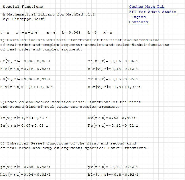

#7 Опубликовано: 30.11.2017 15:27:18
Try with my portable distribution, see signature. There, the mathlib.dll (mathcad special functions) is installed and the bitness of the executable is adjusted.
The screenshot below is from the interactive handbook. You find it using the [?] button in the toolbar in the distribution mentioned above.
Goto Plugins> EFI for SMath Studio> Special functions.
2017-11-30 19_23_19-SMath Studio 0.98.6484 - [Section Special functions.sm].png
mathlib.dll must be uninstalled (removed manually) from the Mathcad EFI plugin. Cephes Mathematical Library contains same functions.
#9 Опубликовано: 30.11.2017 16:17:14
No, you have to set 32-bit version flag for the SMath Studio Desktop exe file.

Many thanks! "Jv" is now defined. But "arctg" is not. Another plugin?
#11 Опубликовано: 30.11.2017 17:52:58
Name of trigonometric functions depend on the function naming type in global settings of your smath studio; in your case you should look for atan

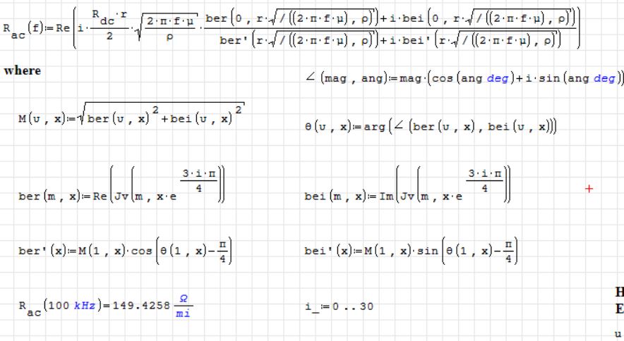

Thank you! Now it computes, but the value; Rac(100kHz) is negative. Should be 141.553Ohm/Mi. I need the "angle" function definition from Mathcad. angle(x, y) Returns the angle from the x-axis to a line containing the origin and the point (x,y). Results are in radians between 0 and 2π, excluding 2π.
#13 Опубликовано: 30.11.2017 18:24:09
angle(x, y)
NFG ... arg(1+1*i)=45°
#14 Опубликовано: 30.11.2017 18:39:13
Norm Schutzkus
Norm Schutzkus
Using an old MC definition I obtained a better value:

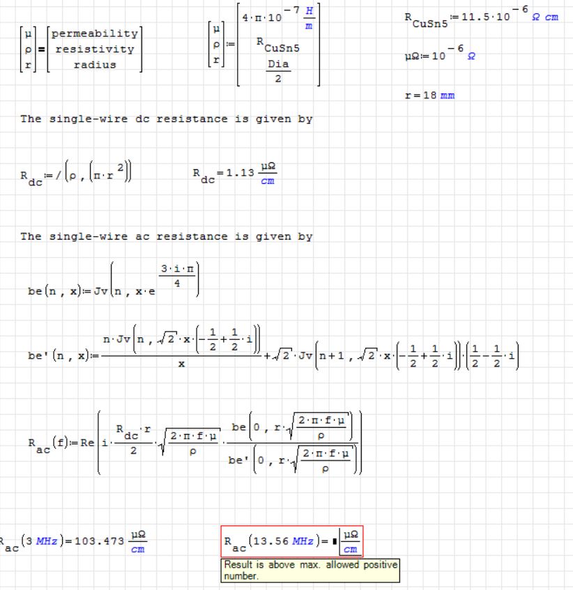

#17 Опубликовано: 06.12.2017 18:17:45
Norm Schutzkus
Norm Schutzkus
Thanks again for the collab's help. The work sheet displays the same result as MC. AC-DC Resistance Using Bessel Functions.sm (12,68 КиБ) скачан 1206 раз(а).
Now I have a fault using a modified sheet that the "Result is above max. allowed positive number." Capture.JPG. The limit for Rac(f) is 9.3MHz, then the error shows.
The result should be 219 micro-ohm/cm. Why the limit?
nas
Bellow Equiv Resistance.sm (14,43 КиБ) скачан 1166 раз(а).

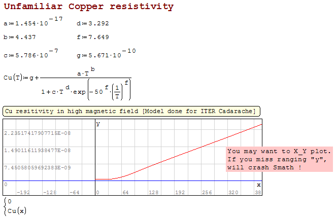

#19 Опубликовано: 07.12.2017 01:26:28
I understand the skin effect from my > 50 years back Electronics.
What I don't understand is the so complicated route to Ohms/MHz.
If you could tabulate some values of that Oms/MHz, I will attempt
a model fit ... something like I did for ITER [Cadarache].

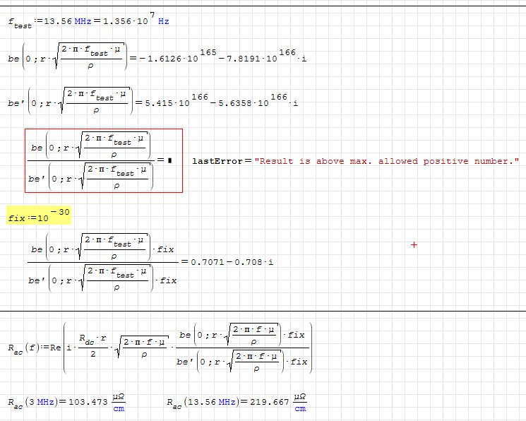

#20 Опубликовано: 07.12.2017 08:40:50
Something triggered in the factorization of the ratio be(...)/be'(...) you can make it working with a trick
