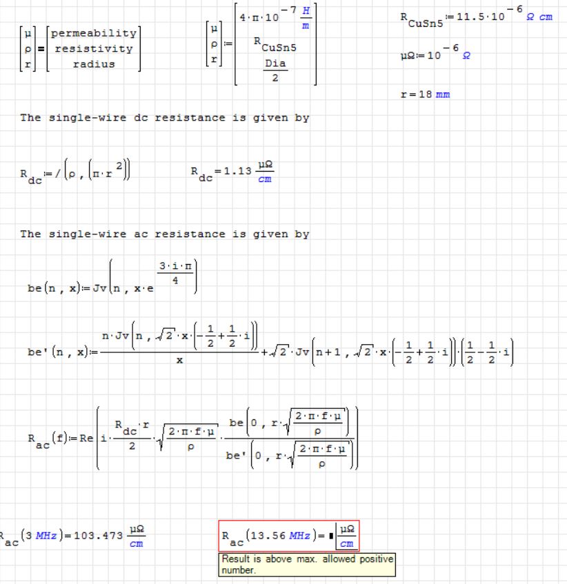

#3 Posted: 11/29/2017 10:23:52 PM

9 likes in 90 posts.

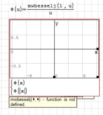

Thanks, for your reply. Unfortunately, I do not see "mwbessl..." listed. Maybe something that I need to activate? Is there a certain plugin I need to load?
Thanks, again

Thanks, again. Unfortunately, the "mwbessel..." function are not defined. I have 23 plugins loaded, all with green check-marks so I think they are all working. "Install all" is not there.
Then again, I do not have admin rights (my work PC), so that may be a problem?

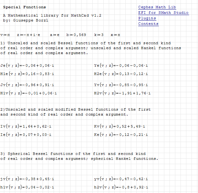

Try with my portable distribution, see signature. There, the mathlib.dll (mathcad special functions) is installed and the bitness of the executable is adjusted.
The screenshot below is from the interactive handbook. You find it using the [?] button in the toolbar in the distribution mentioned above.
Goto Plugins> EFI for SMath Studio> Special functions.
2017-11-30 19_23_19-SMath Studio 0.98.6484 - [Section Special functions.sm].png

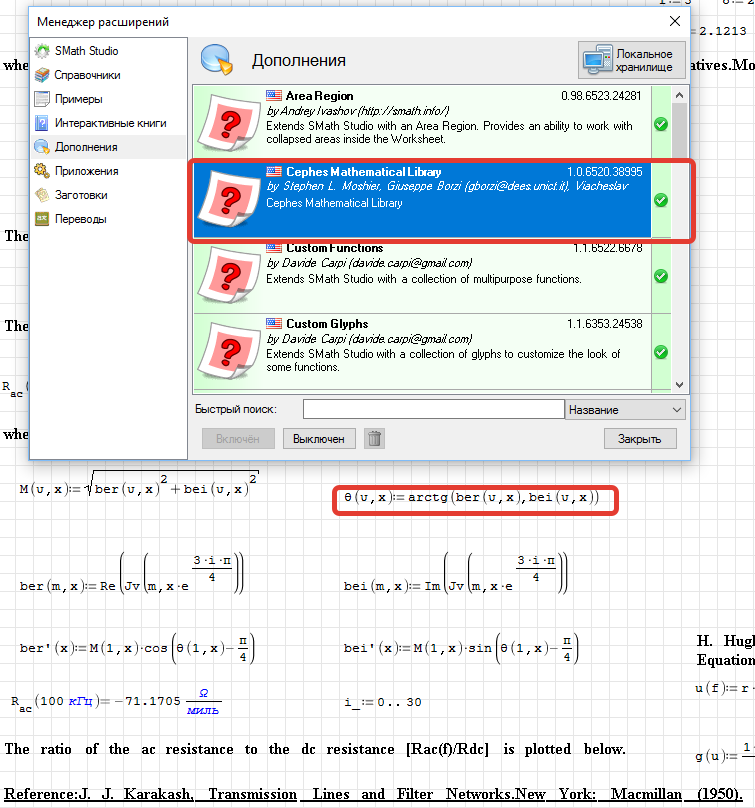

1. Cephes Mathematical Library.
Quote
mathlib.dll must be uninstalled (removed manually) from the Mathcad EFI plugin. Cephes Mathematical Library contains same functions.

Many thanks! "Jv" is now defined. But "arctg" is not. Another plugin?
#11 Posted: 11/30/2017 5:52:58 PM
1,443 likes in 2,936 posts.
Name of trigonometric functions depend on the function naming type in global settings of your smath studio; in your case you should look for atan

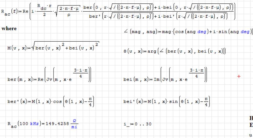

Thank you! Now it computes, but the value; Rac(100kHz) is negative. Should be 141.553Ohm/Mi. I need the "angle" function definition from Mathcad. angle(x, y) Returns the angle from the x-axis to a line containing the origin and the point (x,y). Results are in radians between 0 and 2π, excluding 2π.
#13 Posted: 11/30/2017 6:24:09 PM
angle(x, y)
NFG ... arg(1+1*i)=45°
#14 Posted: 11/30/2017 6:39:13 PM

Using an old MC definition I obtained a better value:

Thanks again for the collab's help. The work sheet displays the same result as MC. AC-DC Resistance Using Bessel Functions.sm (12.68 KiB) downloaded 1206 time(s).

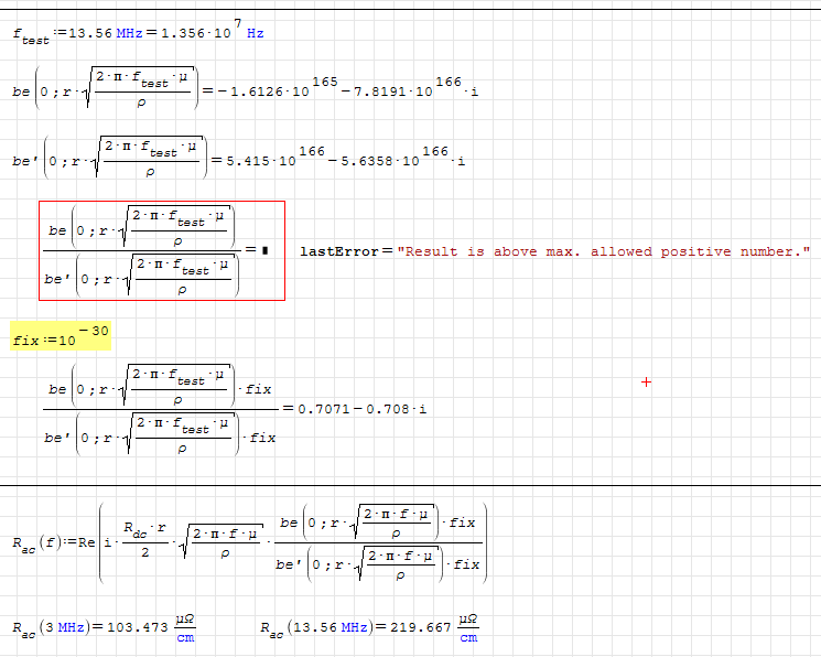

Now I have a fault using a modified sheet that the "Result is above max. allowed positive number." Capture.JPG. The limit for Rac(f) is 9.3MHz, then the error shows.
The result should be 219 micro-ohm/cm. Why the limit?

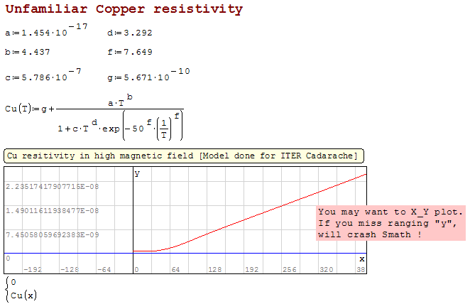

I understand the skin effect from my > 50 years back Electronics.
What I don't understand is the so complicated route to Ohms/MHz.
If you could tabulate some values of that Oms/MHz, I will attempt
a model fit ... something like I did for ITER [Cadarache].
#20 Posted: 12/7/2017 8:40:50 AM
Something triggered in the factorization of the ratio be(...)/be'(...) you can make it working with a trick
