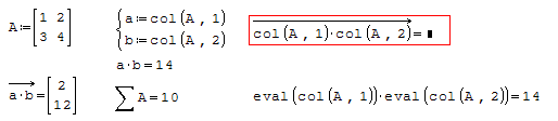

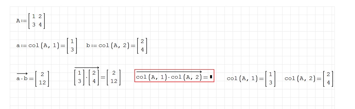

I am having this issue evaluating the vectorized multiplication:
I don't know what the problem could be. I started today switching definitely from Mathcad Prime 5 and started rewriting some codes.

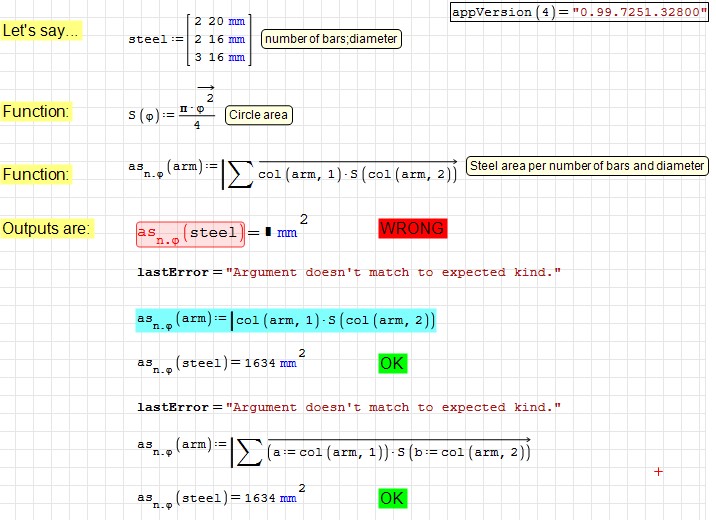

Matrices are multiplied like in a matcade
#3 Опубликовано: 16.04.2020 11:23:24

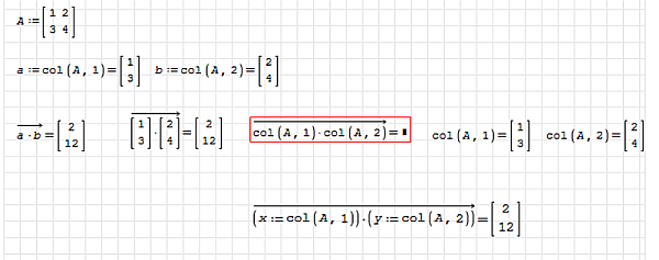

Just a matter of isolating the code
col(A,1), col(A,2) are not like function.
#4 Опубликовано: 16.04.2020 15:52:44
NDTM Amarasekera
NDTM Amarasekera
This way it works.

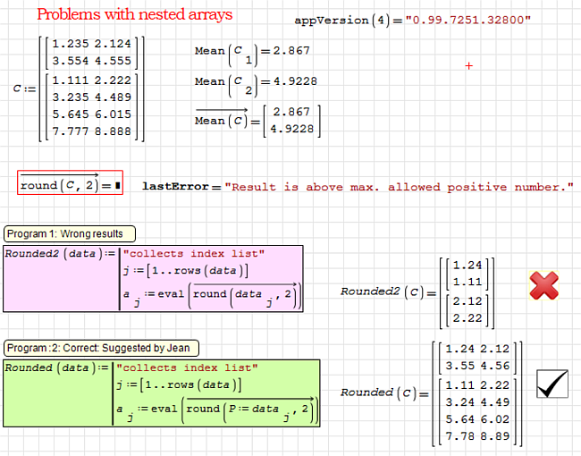

There are some more issues with the vectorize function

Thank you all for your quick responses! Problem solved with ndtma solution. Thank you

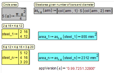

Thank you Jean for your suggestion.

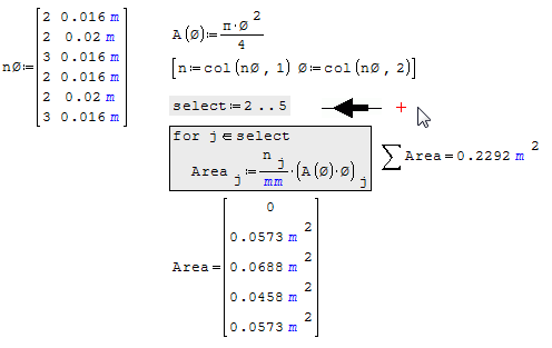

I would rather use a function, because in various parts of my worksheet (beam design), I need that function. It would be like this:
AG24042020-Steel area.sm (6,48 КиБ) скачан 1506 раз(а).

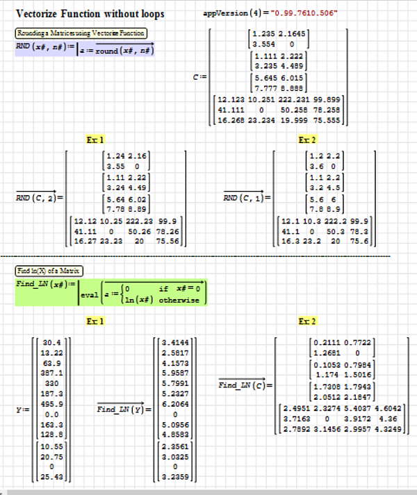

Vectorize function without loops.
Vectorize_Eady.sm (15,01 КиБ) скачан 1479 раз(а).
