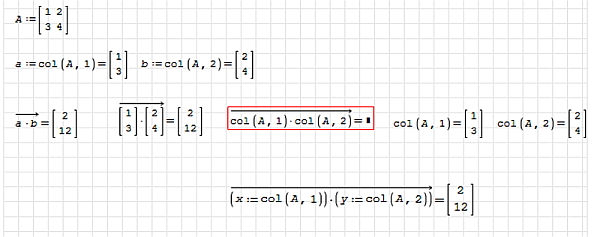

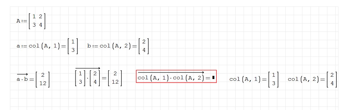

I am having this issue evaluating the vectorized multiplication:
I don't know what the problem could be. I started today switching definitely from Mathcad Prime 5 and started rewriting some codes.
Really happy with the decision I made, and also with the latest SMath studio version, I am running 0.99.7251 SMath.
Thank you in advance for your help,
Alvaro Gavilán
Vectorize.sm (6.15 KiB) downloaded 1454 time(s).

Matrices are multiplied like in a matcade

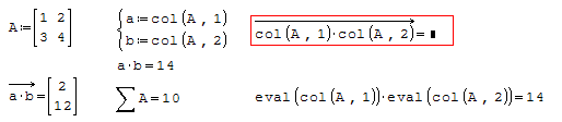

#3 Posted: 4/16/2020 11:23:24 AM
Just a matter of isolating the code
col(A,1), col(A,2) are not like function.

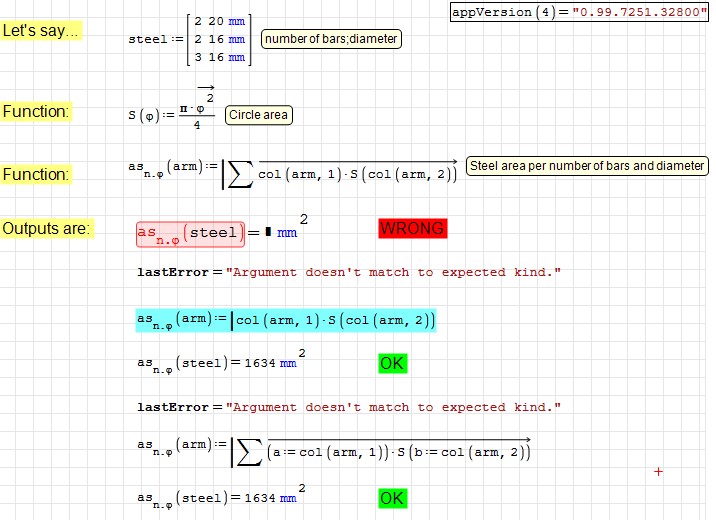

#4 Posted: 4/16/2020 3:52:44 PM
NDTM Amarasekera
NDTM Amarasekera
130 likes in 352 posts.
This way it works.

There are some more issues with the vectorize function

Thank you all for your quick responses! Problem solved with ndtma solution. Thank you
#7 Posted: 4/16/2020 10:55:20 PM
Nice code SS 7251, not supported SS 6179.

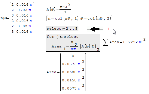

#10 Posted: 4/24/2020 10:45:36 PM
Alvaro Gavilán-Rojas
26 likes in 68 posts.
Thank you Jean for your suggestion.

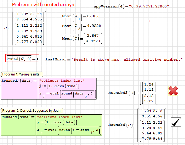

I would rather use a function, because in various parts of my worksheet (beam design), I need that function. It would be like this:
AG24042020-Steel area.sm (6.48 KiB) downloaded 1421 time(s).

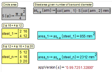

#11 Posted: 4/25/2020 4:45:24 PM
Maybe like this.
Project SteelBar.sm (23.19 KiB) downloaded 1458 time(s).

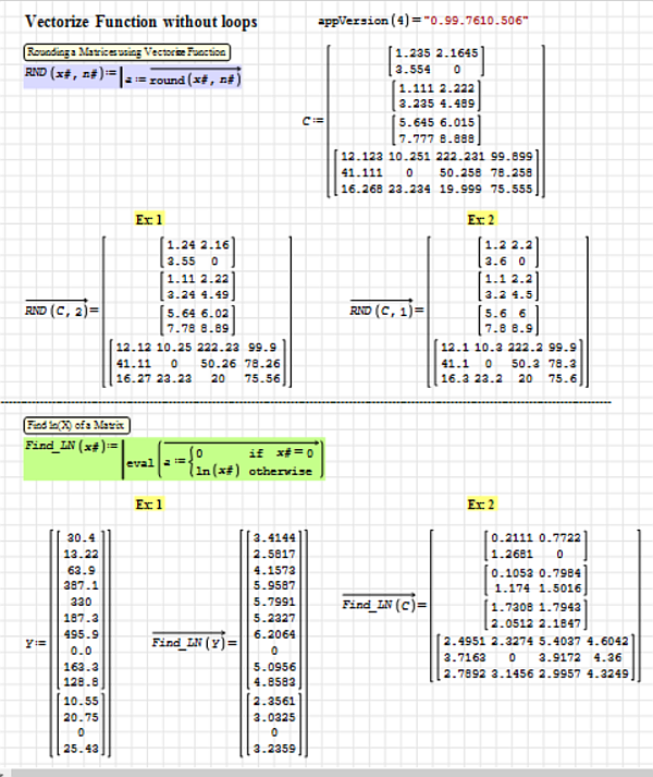

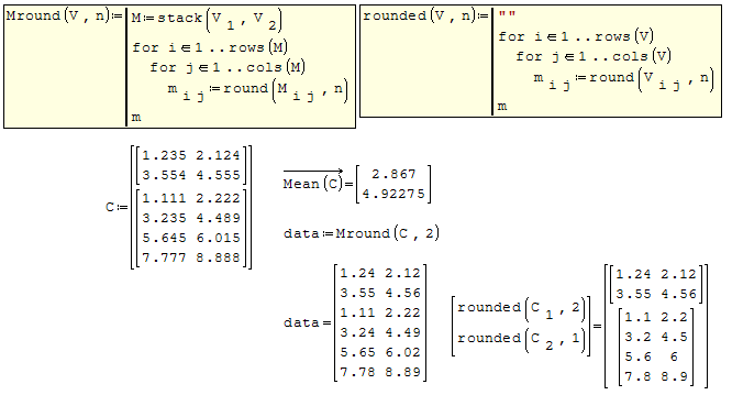

Vectorize function without loops.
Vectorize_Eady.sm (15.01 KiB) downloaded 1381 time(s).
