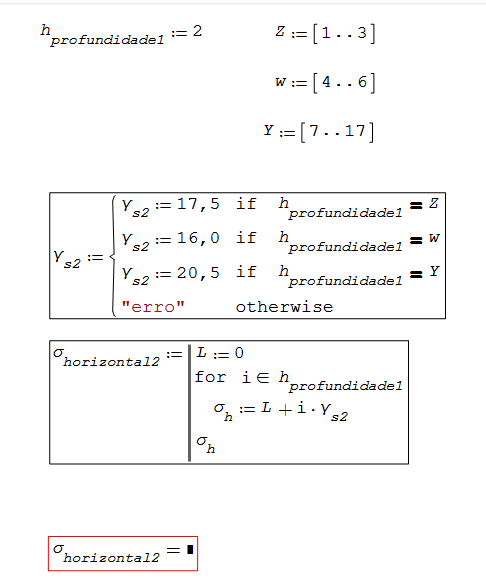

Good afternoon, could someone explain to me how to solve this problem I need that the horizontal voltage varies according to the depth however and the s2 gamma.
my input data is hprofundidade1 z w and y
TESTE TENSAO ADM MATRIZ.sm (5,41 КиБ) скачан 1229 раз(а).

I didn't understand what to calculate in sigma function.
A little more explanation would help to resolve it.

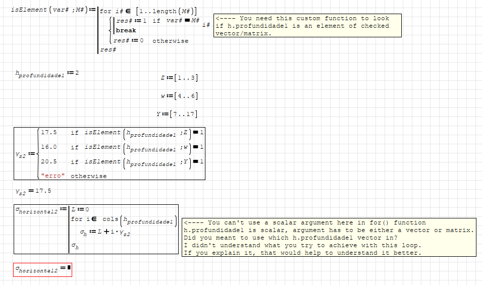

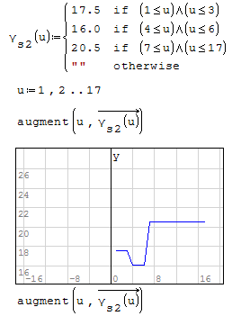

Hi. I think that this could be the solution.
TESTE TENSAO ADM MATRIZ.sm (5,88 КиБ) скачан 1238 раз(а).

I still don't understand purpose of for() loops. (not in your solution, original question)
Removing for()'s and calculating directly won't change the result.

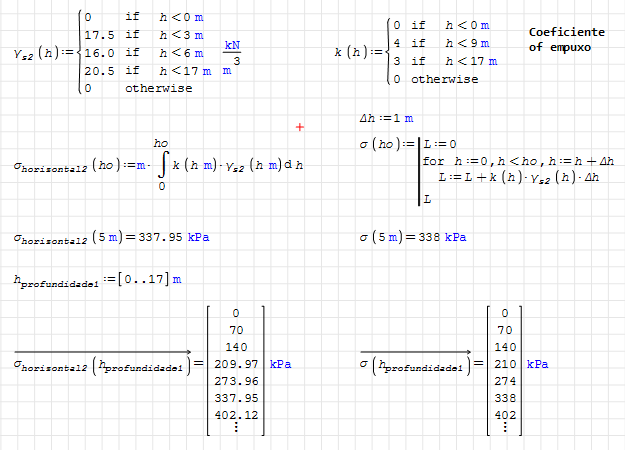

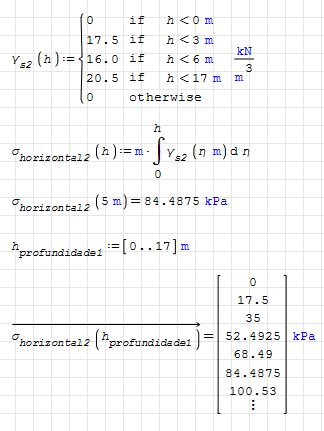

Hi overlord. I guess because using γ.s2(h)*h isn't correct, there the correct acumulation is γ.s2(h)*Δh
TESTE TENSAO ADM MATRIZ.sm (10,8 КиБ) скачан 1211 раз(а).

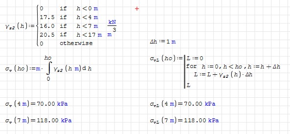

thank you all for making your time available, helping me with this problem but some of the solutions posted here do not match the values must be equal to sigma,v in the image or 70 kN/m2 at 4m depth and 118 kN/m2 at 7m depth.
see the resolution of the problem in the attached image

TESTE TENSAO ADM MATRIZ (in_situ parametric).sm (18,6 КиБ) скачан 1281 раз(а).
PERFECT FELL LIKE A GLOVE is there a way to rotate the result of the graph 90 degrees?

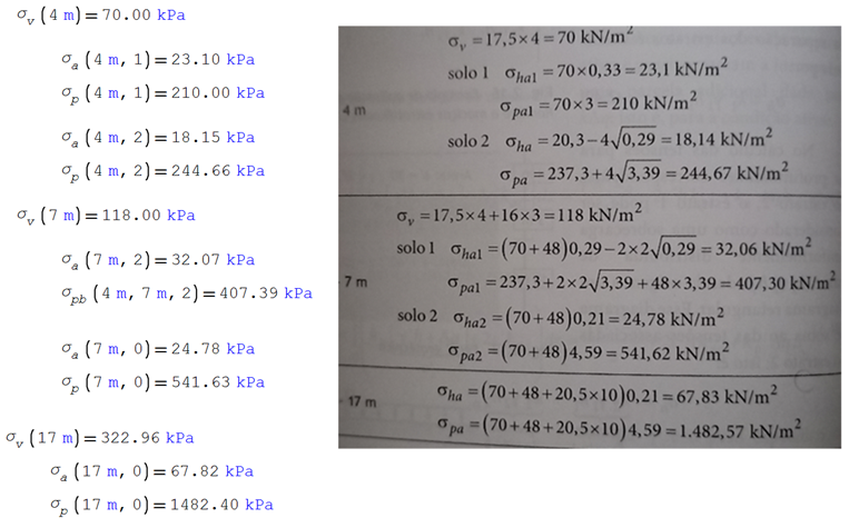

This is a way to do that in SMath.
TESTE TENSAO ADM MATRIZ v2.sm (455,7 КиБ) скачан 1343 раз(а).

... updated from Alvaro latest addition.
Cleaned image(s) for publishing the traced reference.
You can have as many sets of parameters [p,d] as you wish,
even of different length as long as you update respectively.
Cheers ... Jean.
Project Algo_Parameters.sm (661,95 КиБ) скачан 1259 раз(а).
I guess the last 4 'x' points [18,19,20,21] should be removed.
