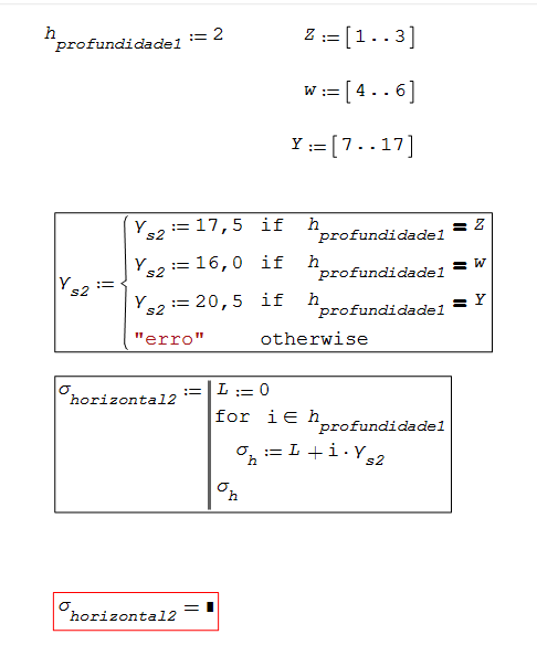

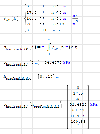

Good afternoon, could someone explain to me how to solve this problem I need that the horizontal voltage varies according to the depth however and the s2 gamma.
my input data is hprofundidade1 z w and y
TESTE TENSAO ADM MATRIZ.sm (5.41 KiB) downloaded 1229 time(s).
I didn't understand what to calculate in sigma function.
A little more explanation would help to resolve it.
I don't understand the problem, only to get a plot.

#4 Posted: 1/6/2022 3:04:40 PM
1,139 likes in 1,805 posts.

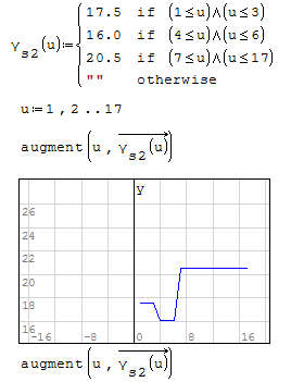

Hi. I think that this could be the solution.
TESTE TENSAO ADM MATRIZ.sm (5.88 KiB) downloaded 1238 time(s).

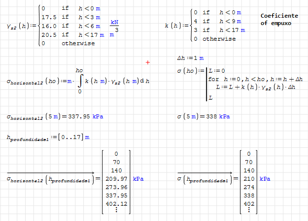

I still don't understand purpose of for() loops. (not in your solution, original question)
Removing for()'s and calculating directly won't change the result.
Hi overlord. I guess because using γ.s2(h)*h isn't correct, there the correct acumulation is γ.s2(h)*Δh
TESTE TENSAO ADM MATRIZ.sm (10.8 KiB) downloaded 1211 time(s).

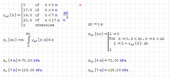

Good morning,

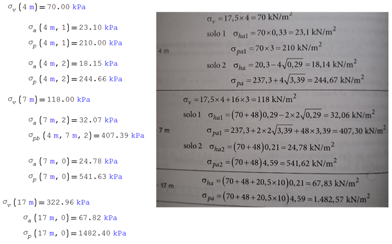

thank you all for making your time available, helping me with this problem but some of the solutions posted here do not match the values must be equal to sigma,v in the image or 70 kN/m2 at 4m depth and 118 kN/m2 at 7m depth.
see the resolution of the problem in the attached image

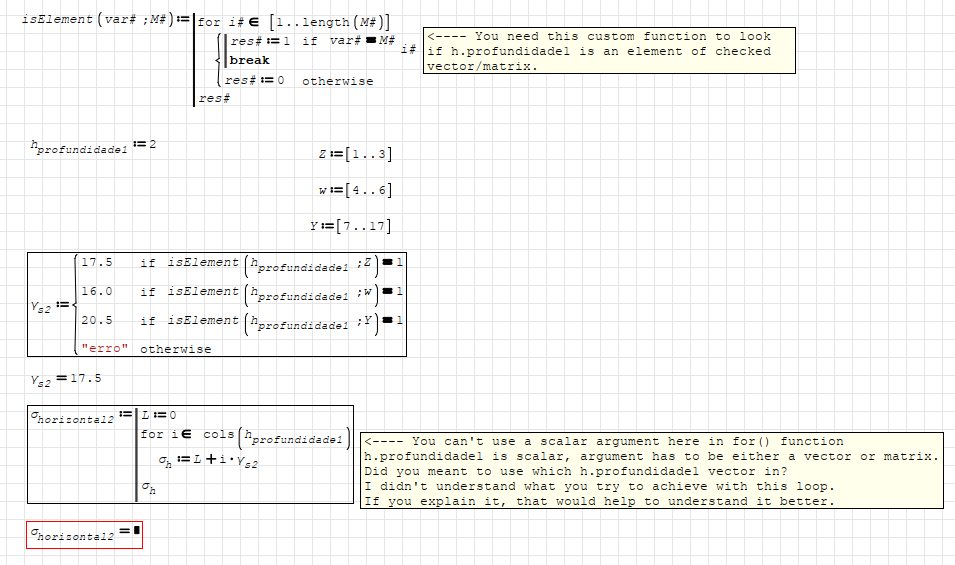

At this point, up to You to handle the project.
I understood nothing in that big image.
TESTE TENSAO ADM MATRIZ (in_situ parametric).sm (18.6 KiB) downloaded 1282 time(s).

...some of the solutions posted here do not match the values must be equal to sigma,v in the image or 70 kN/m2 at 4m depth and 118 kN/m2 at 7m depth.
Hi. You can try to change the input values by yourself.
This is a way to do that in SMath.
TESTE TENSAO ADM MATRIZ v2.sm (455.7 KiB) downloaded 1343 time(s).
