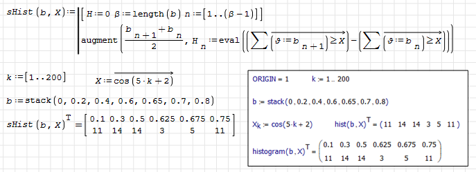

Hi Valery. This function returns the same result as mathcad.
sHist.sm (15,24 КиБ) скачан 1453 раз(а).
Valery Ochkov 11.10.2023 01:53:00, Oscar Campo 11.10.2023 01:24:00

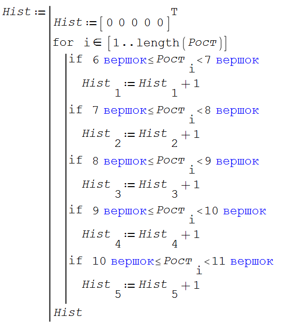

My students histogram

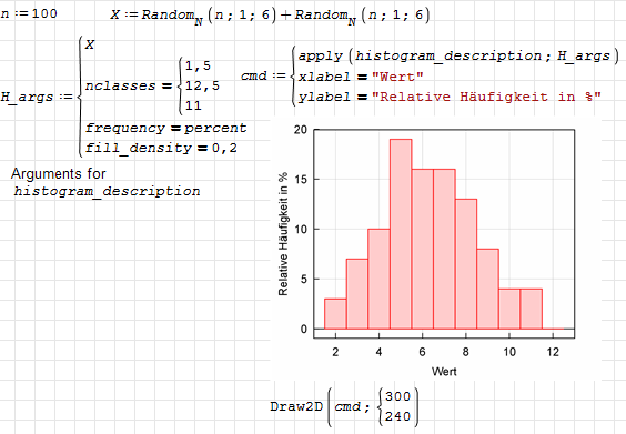

Maxima has a histogram plot function.
Taken from DOI: 10.25933/opus4-2949. The PDF has attached SMath documents.
Valery Ochkov 11.10.2023 20:23:00, Oscar Campo 11.10.2023 09:42:00

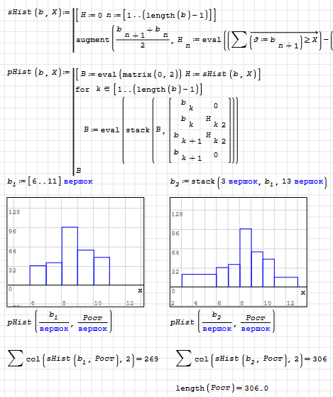

Hi. This version also works with unequally spaced bins.
pHist Mister-Class.sm (61,58 КиБ) скачан 1454 раз(а).
Valery Ochkov 11.10.2023 20:24:00

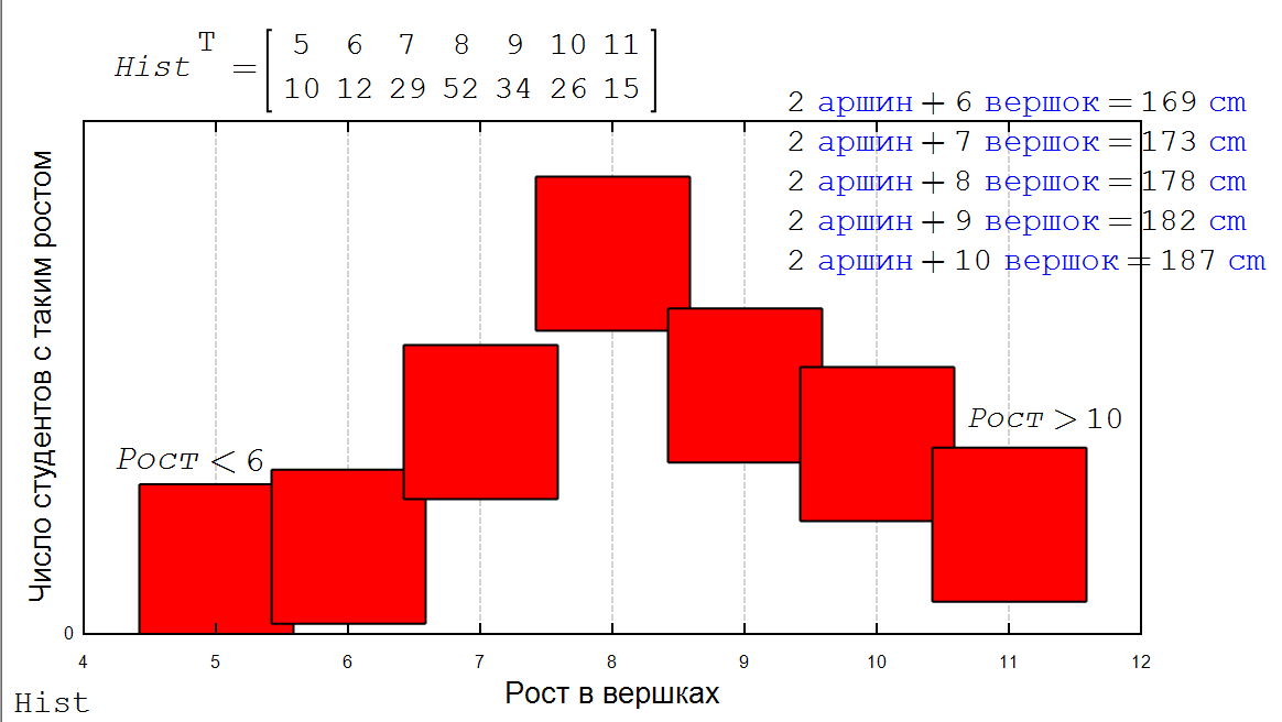

A Live histogram

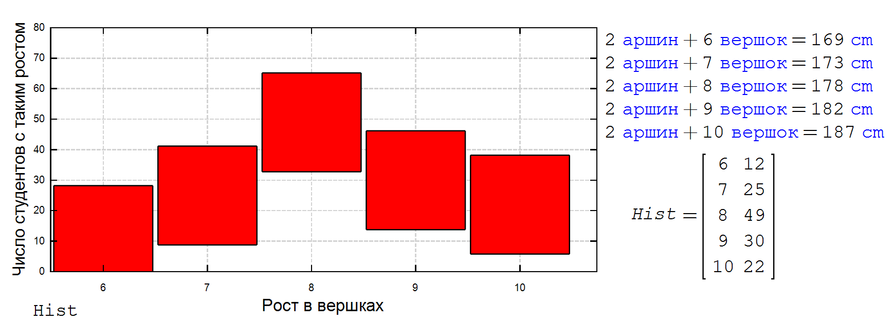

My KISS Histogram

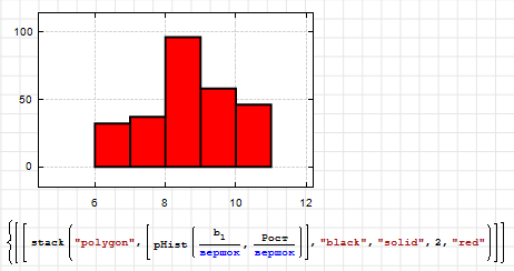

#9 Опубликовано: 12.10.2023 04:48:09
Hi. You can use the above pHist within XYPlot.
Valery Ochkov 12.10.2023 04:49:00, Oscar Campo 12.10.2023 07:32:00
