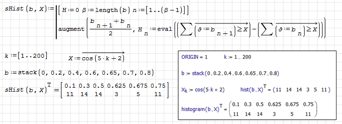

#2 Posted: 10/10/2023 11:36:23 PM
1,139 likes in 1,805 posts.
Hi Valery. This function returns the same result as mathcad.
sHist.sm (15.24 KiB) downloaded 1453 time(s).

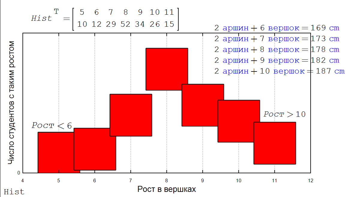

#3 Posted: 10/11/2023 5:25:07 AM
Valery Ochkov
Valery Ochkov
67 likes in 713 posts.
My students histogram

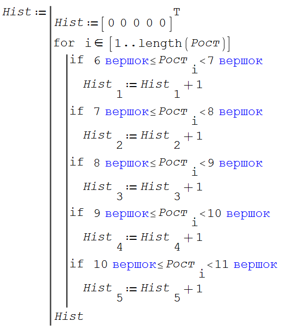

#5 Posted: 10/11/2023 7:43:22 AM
StvMath
StvMath
44 likes and 1 dislikes in 76 posts.
Are you looking for something more ;like this?

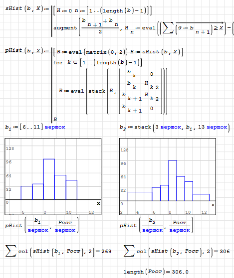

#6 Posted: 10/11/2023 2:43:40 PM
Hi. This version also works with unequally spaced bins.
pHist Mister-Class.sm (61.58 KiB) downloaded 1454 time(s).

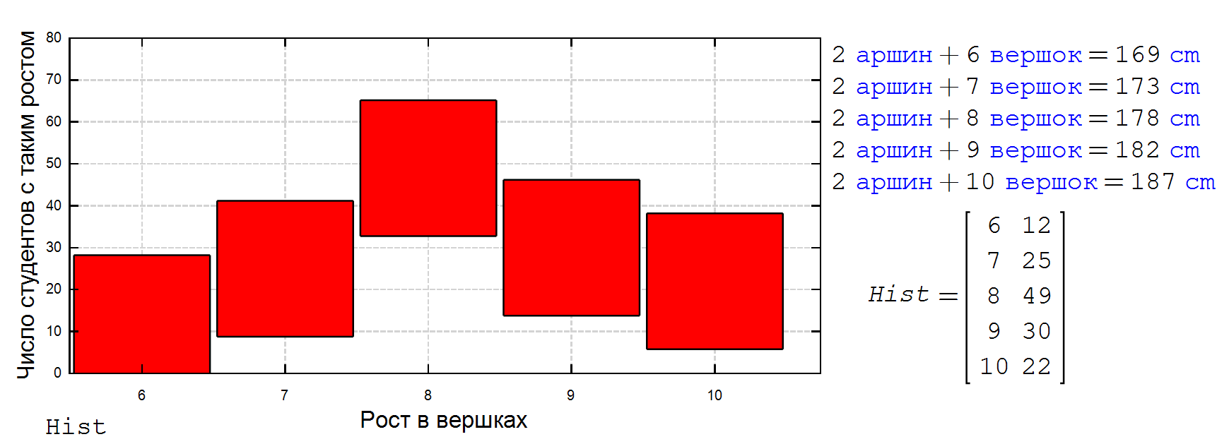

#7 Posted: 10/12/2023 3:08:23 AM
Valery Ochkov
Valery Ochkov
A Live histogram

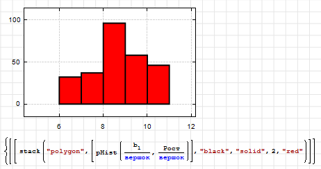

#9 Posted: 10/12/2023 4:48:09 AM
Hi. You can use the above pHist within XYPlot.
