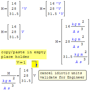

#2 Опубликовано: 06.01.2022 10:01:50
kg*m²/(A*s^3)
What does that mean to the Electrician measuring 735 000 volts ?
A good way to get rid of those stupidities: make units silent

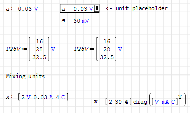

#4 Опубликовано: 06.01.2022 14:21:31
Are there some restriction about it?
For each Matrix that I used, I have to specify each time the unit (like V, mA) instead of the bigger one
You can use the "unit placeholder" for display in the desired unit. Also can display several units for the same vector.
Another feature, I read a topic about it but without enough explanation. It could be very practical to have automatically the appropriate units factor (M,k, , m, µ, n) before the units.
Yes. Or at least an ENG notation mode, like in the calculators, with scientific notation but with exponents multiples of three.
