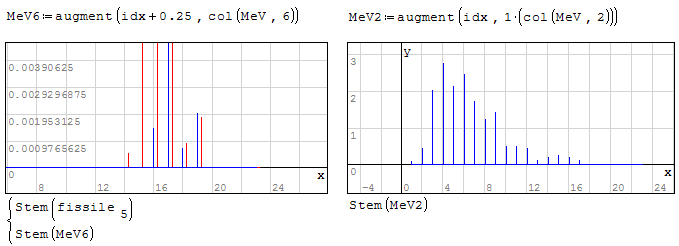

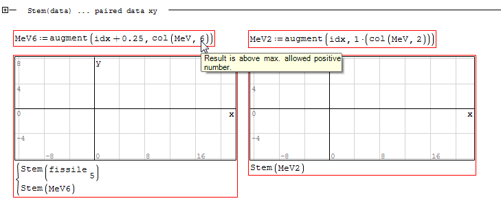

Hello Jean,
Is this what you mean? Checked with version 7019, and plots do not work.

#24 Опубликовано: 15.08.2019 14:04:28
... Is there any red ?
Copy/paste in IrfanView, Resize-Resample to enlarge the ^-
I wish the paper shows some result or graph.

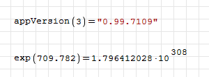

SS 6179 ... exp(709.782)=1.796412028*10^308
SS 7019 ... exp(709.782)= red or something

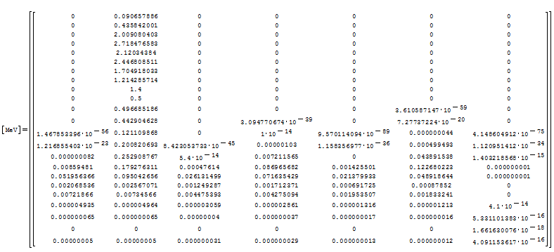

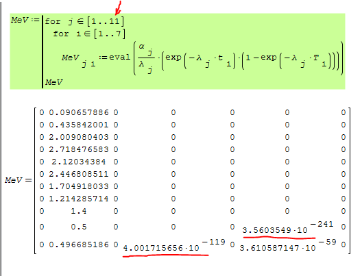

There are some results for the MeV matrix. When the numbers of rows j>11 the red is coming back.
Although there are few differences between the pictures. Some numbers are zero on the first one contrary to some small numbers on the other one.
Is there any significance of this?

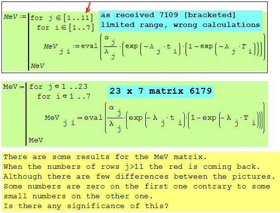

#27 Опубликовано: 16.08.2019 09:25:45
Thanks Radovan for your reply.
YAF.NET refused to quote your message entirely ?
1. Does YAF.NET freaks the ranges to bracket format ?
2. Is it 7109 that freaks the ranges to bracket.
3. What does the bracket range format 7109 vs normal ranges 6179 ?
That kind of problem was observed recently [from recollection NDTMA ?]
What about re-code the ranges 7109 as per 6179 ?
No more from the Originator [graph, results ...]
Maybe not a public paper ... or home made for classroom ?
More puzzling: more Doctors are gone fishing ...

not related with ranges function. even rewriting as for(4)
function, equation gives the same problematic result.
I have downloaded several old versions and found the last
working version is 0.99.6824. After this version there is
none giving the expected result.

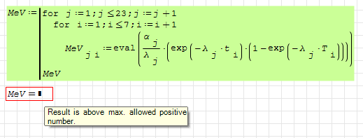

I just put 11 in the range because any number greater than 11 will produce the famous error "...above max. positive number...".
The only thing I can figure out is that the version [7109] (and some versions before) has some serious problems with float/symbolic calculations.
Therefore I can consider this as a serious bug.

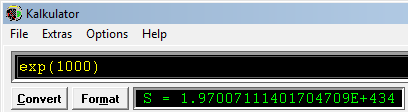

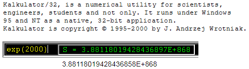

My Kalkulator is older than my Mathcad 8 Pro. [2000]
Does it suggest some profitable code ?
Up until now, this bug hasn't been attended.
How many more undiscovered ?
Thanks Radovan for your dedication, sincerely ... Jean

exp(709.782)=1.79641202802057*10^308
That's what it has to be checked first SS 7019

The utmost limit 709.782 except Kalkulator and Casio
from some method switching from exp(x) to some series.
That kind of magnitude has certainly no interest.
