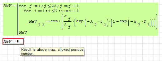

Hello Jean,
Is this what you mean? Checked with version 7019, and plots do not work.

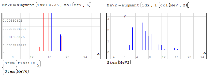

Copy/paste in IrfanView, Resize-Resample to enlarge the ^-
I wish the paper shows some result or graph.

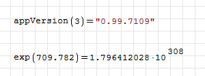

#25 Posted: 8/15/2019 2:19:50 PM
SS 6179 ... exp(709.782)=1.796412028*10^308
SS 7019 ... exp(709.782)= red or something

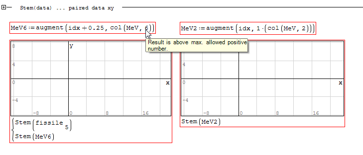

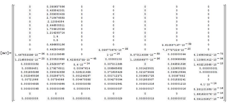

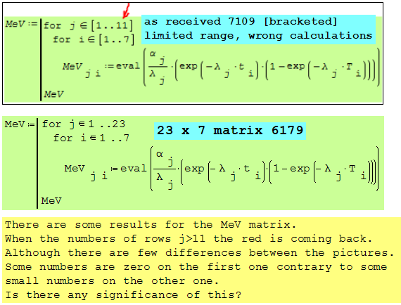

#26 Posted: 8/16/2019 6:19:23 AM
... Is there any red ?
There are some results for the MeV matrix. When the numbers of rows j>11 the red is coming back.
Although there are few differences between the pictures. Some numbers are zero on the first one contrary to some small numbers on the other one.
Is there any significance of this?

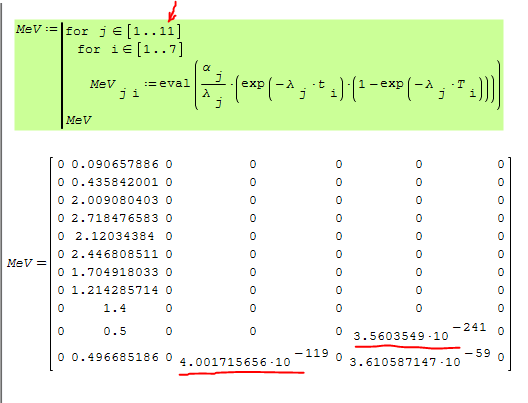

#29 Posted: 8/16/2019 10:34:43 AM
Hello Jean,
I just put 11 in the range because any number greater than 11 will produce the famous error "...above max. positive number...".
The only thing I can figure out is that the version [7109] (and some versions before) has some serious problems with float/symbolic calculations.
Therefore I can consider this as a serious bug.

Simple: tag the big toe of all SS past 6179 Dead Bodies
exp(709.782)=1.796412028*10^308 ... What do you get ?

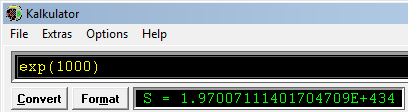

My Kalkulator is older than my Mathcad 8 Pro. [2000]
Does it suggest some profitable code ?

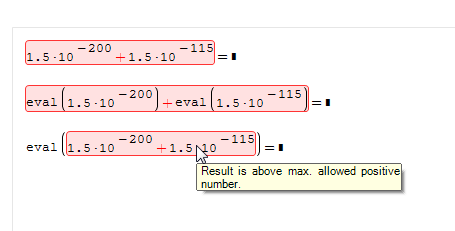

#37 Posted: 8/21/2019 12:47:54 PM
Let me repeat my main point about this error which I believe it is a bug. It is not about exp() function.
Please try in every software you want to calculate this simple addition of two small numbers.
SMath will issue an error (with the rather confusing message) but every other software I tried will not. The result will be either zero or 1.5e-115. That is the point.
overlord 8/21/2019 1:42:00 PM
You are right Radovan, this should be a bug. I have checked the addition on old versions.
0.99.7016 (and older versions) can calculate the mentioned additon, 0.99.7100 and after doesn't.

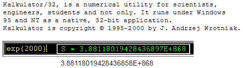

Let me clarify something, exp(709.783) is still not calculated on 0.99.6824 too.
The utmost limit 709.782 except Kalkulator and Casio
from some method switching from exp(x) to some series.
That kind of magnitude has certainly no interest.

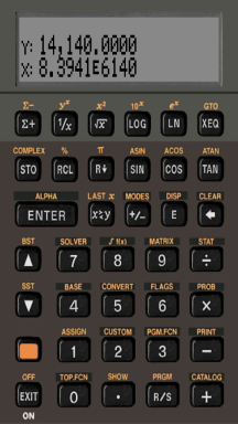

#40 Posted: 8/21/2019 6:46:44 PM
CBG
CBG
78 likes in 312 posts.
The Free42 calculator for Android supports the value of 14,140 for the exp () function
exp (14140) = 8.3941 E+6140
Carlos
