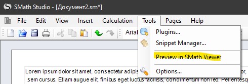

> Preview in SMath Viewer menu item added to Tools menu;
What's "SMath Viewer"?
Hello.
Please look into the following thread for the details about SMath Viewer: https://en.smath.com/forum/yaf_postst1784_SMath-Viewer.aspx
Wrote...
Oh, thanks. I forgot that this is the name for make executables files. I guess that isn't the best name for that! Usually "Viewer" means a version for read files but without buying the software. There are also another "modes". Mathcad have some other. For instance, the web application server, with a lot of examples from Valery Ochkov. This could be a good bussines area for SMath for distribute worksheets in an enterprise intranet.

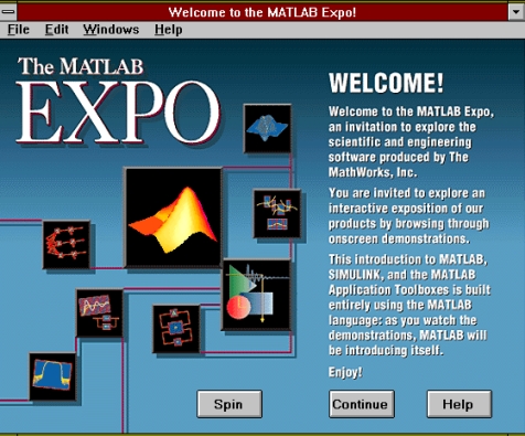

I think that the viewer "mode" is more than an "application server", but without a web based interface. Matlab have those both modes too. For example, this is the "Matlab expo" from an old version.
This is yow it look for one example
Notice that this could be called like a "slide mode" for matlab, but make those slides requires programming skills.

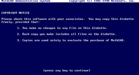

Mathcad demo mode that I have it's old: it's for DOS. Here the starting msg saying that it is free for distribute, under certain conditions:

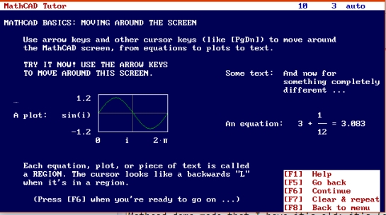

And here is how it looks:
This is the demo folder for mathcad for DOS.
