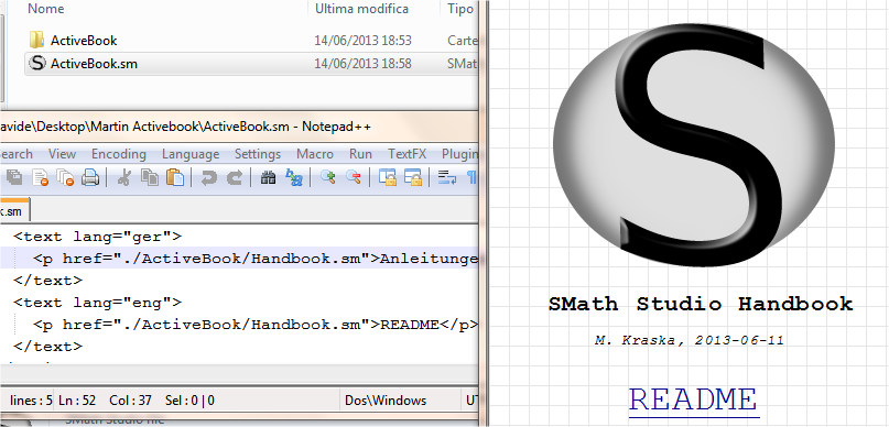

Hi Martin
First of all, wonderful job, that's the most closer attempt to a SMath's embedded guide
2nd (@Andrey) I think that an additional attribute could be added to enable/disable an "Handbook mode"; f.e. that option can enable the toolbar that you have provided for the reference book
3rd (@Martin) IMHO, as for now, a tree-based structure for the files is needed (at least a simple double level structure) to make the Handbook file easier to find (I've attached a couple of screenshots); in the other hand if Andrey found a better way to handle SMath's handbooks, an additional attribute "Handbook root" applied to the main file would be enough

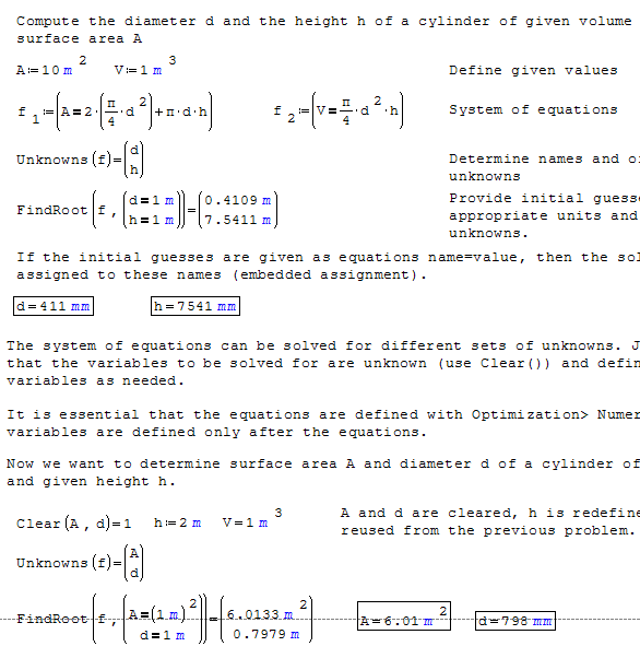

#9 Опубликовано: 14.06.2013 11:59:08
I cannot reproduce the solver problem in the screencast. The default precision is 4 decimal places, whatever that means: 4 significant digits (would be the preferred and only unit-independent variant) or an epsilon setting of 10^-4.
Strange, this is not happening on my Win7 32bit

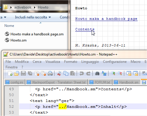

#10 Опубликовано: 14.06.2013 12:50:20
For now, the need to find the handbook root is mitigated by all pages having the back link included.
You're right
BTW a 3rd way could be to add all the worksheets inside a folder and to add an additional "cover" worksheet outside this folder with a link to the HandBook.sm; this not require many efforts and help to have a clear front-end.
I've seen now your video, I do not understand from where the initial results come...
