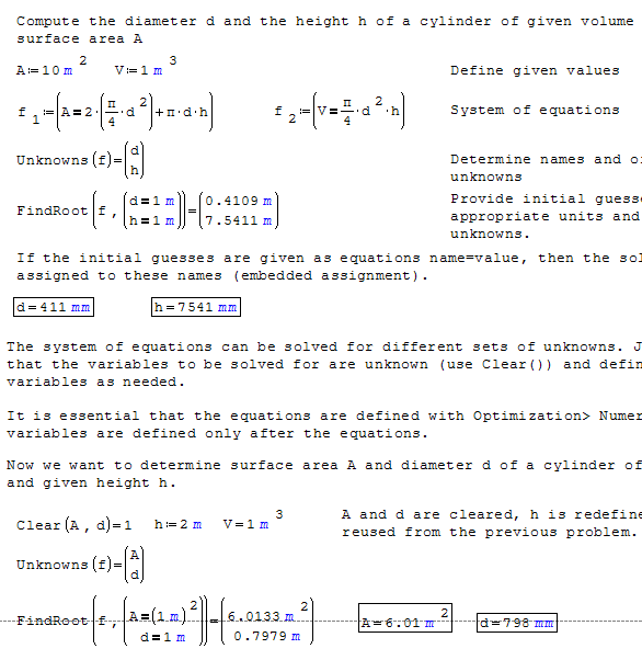

Radovan, thanks for the demo video of the handbook.

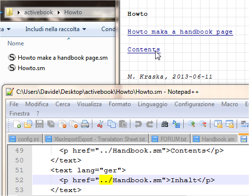

Handbook updated (file in first post exchanged)
- Added page "Howto add linked handbook pages"
- Added templates for handbook pages
- minor corrections and added function descriptions.
I cannot reproduce the solver problem in the screencast. The default precision is 4 decimal places, whatever that means: 4 significant digits (would be the preferred and only unit-independent variant) or an epsilon setting of 10^-4.

I just like these screencasting thing (thanks to kilele).
Your ideas about templates and Handbook organization is something SMath just needs. I fully accept that. Help file inside SMath based on the Handbook principles made by you, would be something great. I would very gladly translate it into my native language and keep tracking about it.
Thank you for the explaining about links. I new something was about that. It still does not seem to be attractive for some other users. The most desirable behavior would be just to make this linking thing the as simple as possible, without manual file editing in some HTML,XML editor. We should concentrate on files and links and their organizations. I hope that Andrey will find the way to add some feature regarding the links in order to make it simpler to insert and use.
One minor observation. I still do not understand why I should use CTRL+click for using the links, while in the Reference Book just simple mouse click will do the thing. Keeping the finger on CTRL button while browsing the files and contents is not quite appealing.
About the FindRoot() in your example. I do not know why I get different result (Win7 64bit), but I messed up with different Nonlinear Solvers by Davide (some of them were totally unofficial). I think we should not worry about this at the moment. We will see when Davide announce the official version.

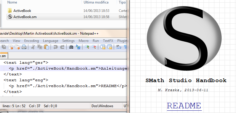

#5 Posted: 6/14/2013 9:48:34 AM
1,443 likes in 2,936 posts.
Hi Martin
First of all, wonderful job, that's the most closer attempt to a SMath's embedded guide
2nd (@Andrey) I think that an additional attribute could be added to enable/disable an "Handbook mode"; f.e. that option can enable the toolbar that you have provided for the reference book
3rd (@Martin) IMHO, as for now, a tree-based structure for the files is needed (at least a simple double level structure) to make the Handbook file easier to find (I've attached a couple of screenshots); in the other hand if Andrey found a better way to handle SMath's handbooks, an additional attribute "Handbook root" applied to the main file would be enough
Best regards,
Davide

#9 Posted: 6/14/2013 11:59:08 AM
Strange, this is not happening on my Win7 32bit
I've seen now your video, I do not understand from where the initial results come...

How about this one. Just unpack the contents of the zip file in post #1 to a subdir activebook in your smath book directory and exchange the attached contents.sm. Then you have handbook access via Help.
