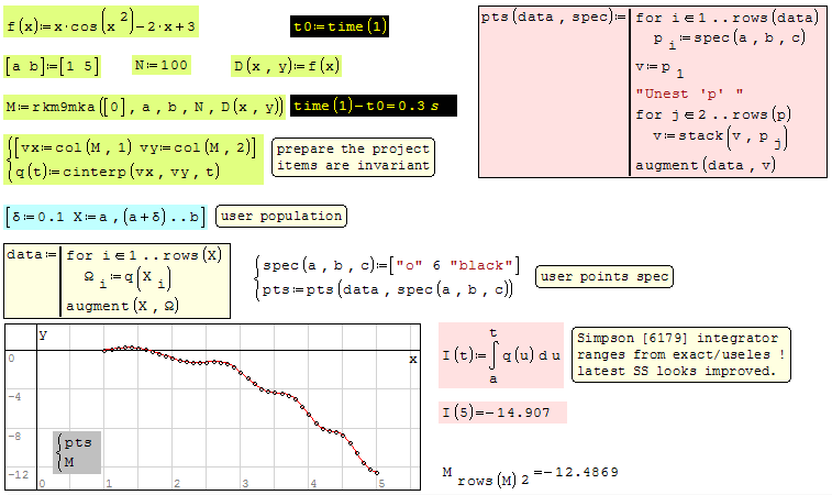

1/1 in Smath 6179, proof: the snippet.
Cheers Alvaro
Integrate with ode solver.sm (29,07 КиБ) скачан 1208 раз(а).

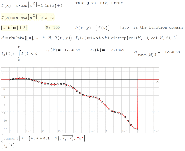

Hi Jean. Actually not, just the solver, without the given.
I found how to call the odesolver, with D(x,y)=[f(x)].
This method is much more faster than the direct integration.
But remains the ln(0) error, which seems to be a bug in the odesolvers, because zero isn't in the domain range.
Integrate with ode solver.sm (10,17 КиБ) скачан 1144 раз(а).
Buenos dias Alvaro !
ln(0) was introduced in Mathcad 11 soon after release via update [from recollection]
There is more in the attached, specially wrt parametric D(,,,).
ODE 0_Model General.sm (29,47 КиБ) скачан 1189 раз(а).

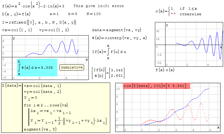

... refreshed version wrt explore all solvers.
ODE 0_Model General.sm (38,44 КиБ) скачан 1161 раз(а).
