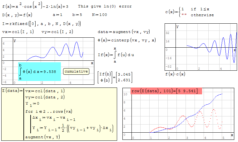

WroteI can't reproduce this in SMath.
1/1 in Smath 6179, proof: the snippet.
Cheers Alvaro
Integrate with ode solver.sm (29.07 KiB) downloaded 1316 time(s).
#3 Posted: 11/29/2018 11:59:54 PM
You may not be able to implement the Mathcad bloc Given/ODEsolve.
ODEsolve is based on linterp. That is the first point.
The other point is that in Mathcad "linterp(x)" is a scalar function.
In Smath: ainterp, cinterp, linterp are simply interpolation fncts
They are not scalar functions. How does it reflects in ODEsolve ?
In Smath, ln(x), exp(x), ... are scalar from source code.
I tried to make cinterp scalar like in Mathcad, not to avail.
Please, persist on such a beautiful idea.
#4 Posted: 11/30/2018 1:16:48 AM
WroteI tried to make cinterp scalar like in Mathcad, not to avail.
This document was essentially designed to plot scalar the derivative on canvas,
as well as get a discrete export. Also included: the scalar quadratic.
Spline Deriv Infinitesimal.sm (70.87 KiB) downloaded 1330 time(s).

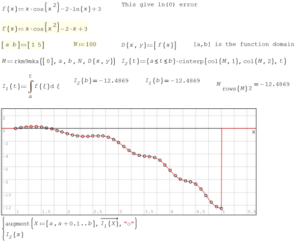

#5 Posted: 11/30/2018 2:31:22 AM
Hi Jean. Actually not, just the solver, without the given.
I found how to call the odesolver, with D(x,y)=[f(x)].
This method is much more faster than the direct integration.
But remains the ln(0) error, which seems to be a bug in the odesolvers, because zero isn't in the domain range.
Integrate with ode solver.sm (10.17 KiB) downloaded 1255 time(s).

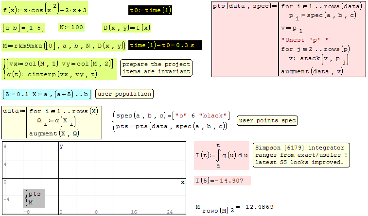

#8 Posted: 11/30/2018 12:29:42 PM
WroteHi Jean. Actually not, just the solver, without the given.
Buenos dias Alvaro !
ln(0) was introduced in Mathcad 11 soon after release via update [from recollection]
There is more in the attached, specially wrt parametric D(,,,).
ODE 0_Model General.sm (29.47 KiB) downloaded 1291 time(s).

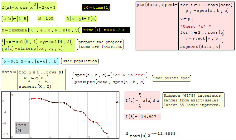

#9 Posted: 11/30/2018 12:34:54 PM
#10 Posted: 11/30/2018 3:36:38 PM
... refreshed version wrt explore all solvers.
ODE 0_Model General.sm (38.44 KiB) downloaded 1253 time(s).
