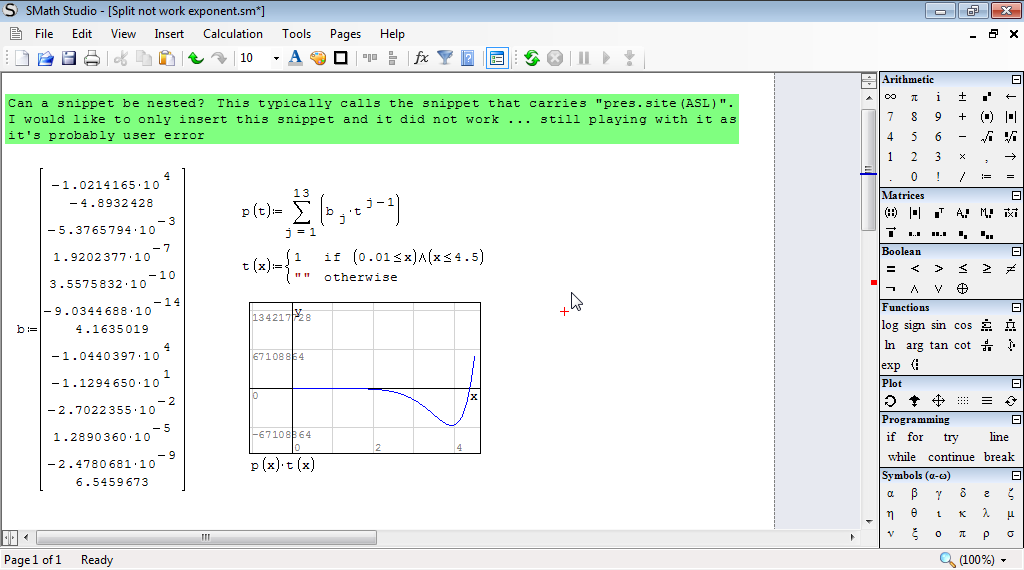

I have a few questions
  1. Can a snippet be nested? I have a function "snippet" that relies on another snippet. This file is an example and I want to reference only this snippet function which will embed the other snippet function
  2. Do Snippets need to be saved as SM? I had an issue with my SMZ files which I default to saving everything out of habit. I have not tried this version
  3. Equation wrap does not work on exponents. I know this feature is a work in progress. I even posted a work around
Split not work exponent.sm (14,33 КиБ) скачан 1801 раз(а).

Andrey,
User error on the Snippet. Because snippets are static, you can embed one Snippet that calls on another Snippet. I thought it was more of a reference like rfile. I like to go back and update documentation/clarifications as time goes by.

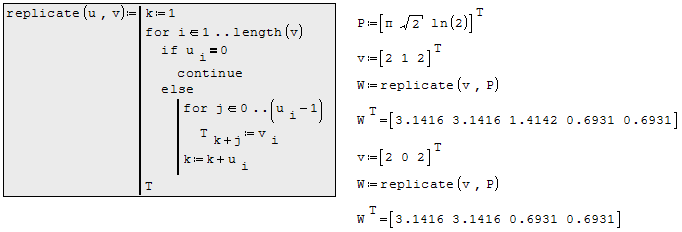

A message like "element assignment is only possible for empty or matrix objects" would help. I am not aware of other situations where such an assignment might fail, thus this message could be used by default in failing element assignments.
"element assignment is only possible for empty or matrix objects" ... I like it
"can not calculate" is much more real because there is nothing to calculate.
If some wish list would ask for Mathematica style zillions error messages,
that will not replace reading the Smath Handbook.
"for loop can not index a constant"
"not a scalar assignment" [typical Mathcad style]
As it looks, the matter was to replicate a value.
