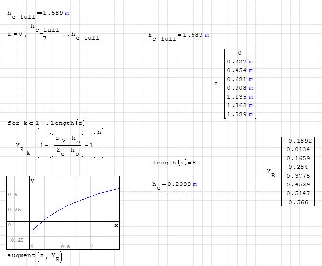

I wish to loop through the YR formula, in pic below, for values of z being 0,0.2,0.4,0.6,0.8,1.0,1.2,1.4,1.589.

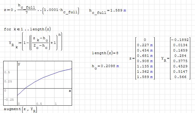

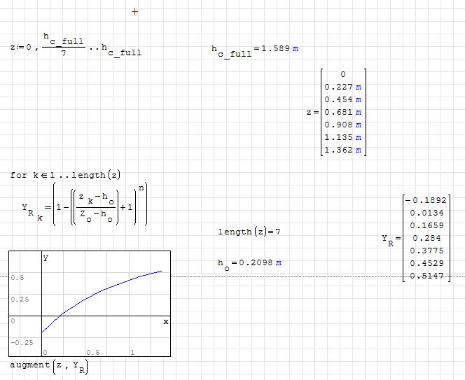

My progress so far is to produce an array evenly spaced z values and if the 1.0001 factor is not applied to hc_full then the last element of the z array is 1.362, rather than 1.589.
It is obvious to me that I have some missing skill here, please throw me some hints.
Regards, Tim

Just define your 'x' vector of values, include in small loop.
AtWill.sm (6,78 КиБ) скачан 1239 раз(а).

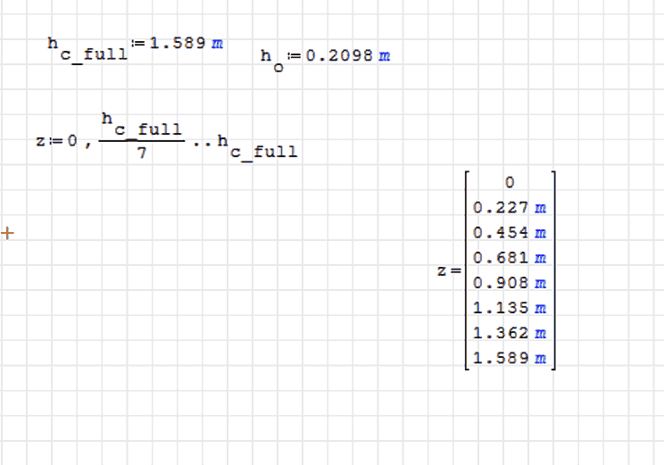

Thank you for typing the work from scratch, and showing no issue with the 1.589 value.

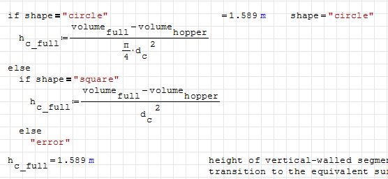

I redefined hc_full immediately above the z range call and then the output changed to match your results.
The hc_full is defined with an if statement.
The 1.589 value is absent from the z range.
The hc_full is redefined directly above the z range call (to override the value produced by the if statement) and the 1.589 value is now present in the z range.
Have I contravened a working principle in some way?
Tim

Redefining hc_full using hc_full:=hc_full also fixes the z range array.
Tim

WroteHave I contravened a working principle in some way?
Maybe not ? work sheet would help and no help.
Smath 6179 does not take index on the RHS.
hopper.sm (187,84 КиБ) скачан 1247 раз(а).

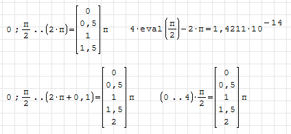

for(3)-loops with initial, second and maximum value aren't robust if floating point values are specified. The internal representation of such numbers may differ from what is displayed due to round-off.
Due to this it is not good programming style to test the equality of two floating point numbers without specifying a tolerance. If you want to be safe, you either introduce such a tolerance or you generate the list of values based on a list of integers.
It should be possible to modify for(3) such that the tolerance is generated as a fraction of the difference between first and second value.
![2017-10-12 22_36_42-SMath Studio - [Blatt4_].png](/ru-RU/files/Download/PacnKP/2017-10-12-22_36_42-SMath-Studio---[Blatt4_].png)
