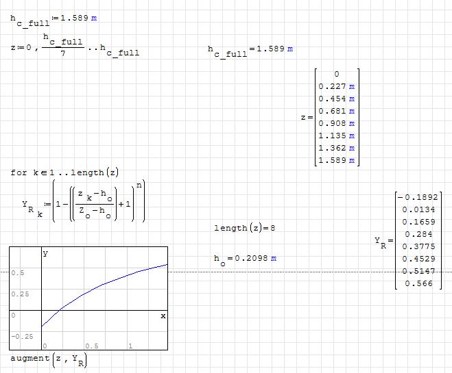

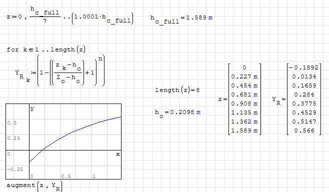

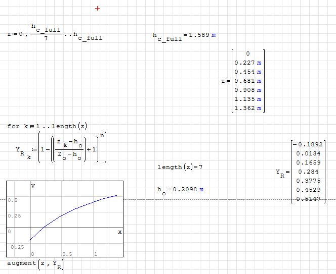

I wish to loop through the YR formula, in pic below, for values of z being 0,0.2,0.4,0.6,0.8,1.0,1.2,1.4,1.589.
My progress so far is to produce an array evenly spaced z values and if the 1.0001 factor is not applied to hc_full then the last element of the z array is 1.362, rather than 1.589.
It is obvious to me that I have some missing skill here, please throw me some hints.
Regards, Tim
Regards, Tim

#3 Posted: 10/11/2017 3:49:55 PM
Hi Jean,
Thank you for the example file, I will study this for better understanding.
I have longer arrays to create also so wish to automate; if I make z as in the pic or with equal spacing, is there a means of appending the final (1.589) value to the end of the array?
Tim
Tim

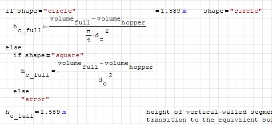

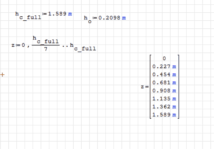

#7 Posted: 10/12/2017 5:28:21 AM
Jean,
Thank you for the counter loop example, this will stretch my programming comprehension.
CBG,
Thank you for typing the work from scratch, and showing no issue with the 1.589 value.
I redefined hc_full immediately above the z range call and then the output changed to match your results.
The hc_full is defined with an if statement.
The 1.589 value is absent from the z range.
The hc_full is redefined directly above the z range call (to override the value produced by the if statement) and the 1.589 value is now present in the z range.
Have I contravened a working principle in some way?
Tim
CBG,
Tim
#8 Posted: 10/12/2017 5:38:09 AM
Redefining hc_full using hc_full:=hc_full also fixes the z range array.
Tim
Tim

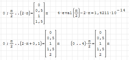

#10 Posted: 10/12/2017 5:45:07 PM
for(3)-loops with initial, second and maximum value aren't robust if floating point values are specified. The internal representation of such numbers may differ from what is displayed due to round-off.
Due to this it is not good programming style to test the equality of two floating point numbers without specifying a tolerance. If you want to be safe, you either introduce such a tolerance or you generate the list of values based on a list of integers.
It should be possible to modify for(3) such that the tolerance is generated as a fraction of the difference between first and second value.
![2017-10-12 22_36_42-SMath Studio - [Blatt4_].png](/en-US/files/Download/PacnKP/2017-10-12-22_36_42-SMath-Studio---[Blatt4_].png)
loop.sm (4.84 KiB) downloaded 1254 time(s).
