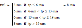

All,
I am new user, need your help how to create this type of equations in Smath

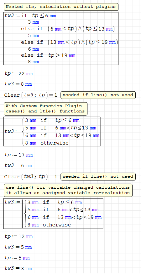

#2 Опубликовано: 15.06.2023 07:36:01
if_function.sm (12,23 КиБ) скачан 1362 раз(а).

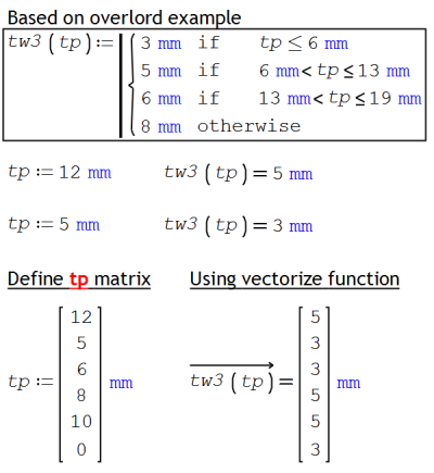

#3 Опубликовано: 15.06.2023 11:42:20
NDTM Amarasekera
NDTM Amarasekera
Based on program by overlord.
if_function_ndtma.sm (27,85 КиБ) скачан 1368 раз(а).

#5 Опубликовано: 16.06.2023 06:54:18
... from the drop down fx menu.
Making it a function as Amarasekera did is much more sensible solution.
