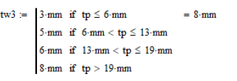

All,
I am new user, need your help how to create this type of equations in Smath

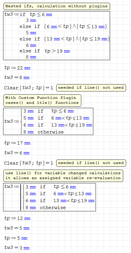

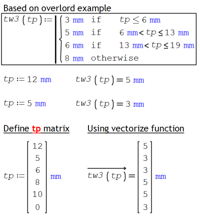

#3 Posted: 6/15/2023 11:42:20 AM
NDTM Amarasekera
NDTM Amarasekera
130 likes in 352 posts.
Based on program by overlord.
if_function_ndtma.sm (27.85 KiB) downloaded 1368 time(s).

#6 Posted: 6/16/2023 10:25:58 AM
600 likes in 1,381 posts.
Making it a function as Amarasekera did is much more sensible solution.
