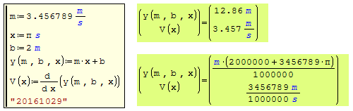

SMath, as I know, have two evaluators: Numeric (=) and Symbolic (Ctrl + .). I guess that what you want is a new evaluator: Substitute for knows (Ctrl + , perhaps)?

#4 Posted: 5/27/2016 1:00:16 AM

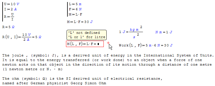

#6 Posted: 10/25/2016 9:27:44 PM
Can anyone advise if it would be feasible to write an extension to accomplish this?
Your 2nd option is redundant. It has no interest in applied
Scientific/Engineering works. Why sould it be of some use
otherwise [teaching/Edu/publishing ...].
That's my answer, not my business.

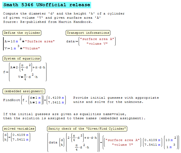

#9 Posted: 10/26/2016 2:04:19 PM
To the wording of your thread "Evaluation of a formula with units"
That is the task of symbolic, that's why the red snippet in my reply.
In Professional works, we define/indentify the contex/units ...
then produce the document(s).
I don't understand your zillions pages long formula.
I don't understand /One page later, /Two pages later,/Three pages later
Attach something: collabs will read .
