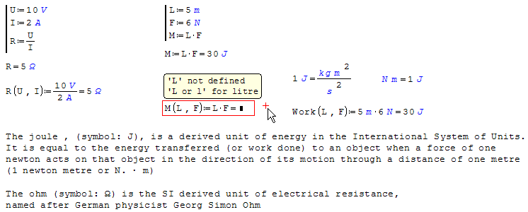

SMath, as I know, have two evaluators: Numeric (=) and Symbolic (Ctrl + .). I guess that what you want is a new evaluator: Substitute for knows (Ctrl + , perhaps)?

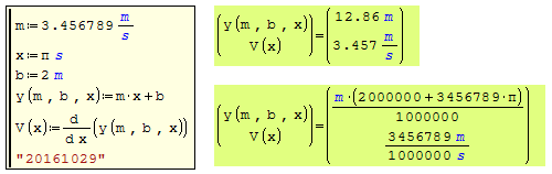

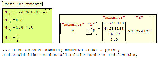

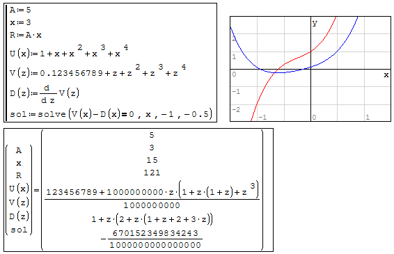

What you are suggesting defeats the purpose of using a program like SMath because that can be easily achieved in Excel. What you are showing (twice now) is not the same as what is being requested, it is very different, that's why two different people on two different occasions have asked for something despite your previous example. What we want is clearly shown. Following your example, we either 1) have to re-show the variables prior to each calculation, or 2) redefine the variables prior to each calculation, or 3) redefine the equation prior to each calculation.
Regarding the equation being broken up over three lines (symbolic, numeric, result), that form absolutely is used in applied engineering. If you have a very long equation, such as when summing moments about a point, and would like to show all of the numbers and lengths, it is very cumbersome to have a gigantic equation on one line; you would likely have to adjust your page width to fit such a formula or break it up into multiple separate formulas, which again, for my needs, defeats the purpose of using a program like SMath.
